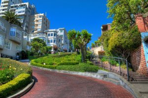

The attached images do not relate to my specific condition. I am reluctant to post pictures of the area of interest because of pending litigation.
