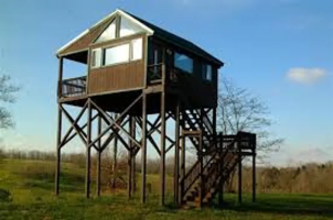

I've been looking all over the internet for an answer to this and cannot find answers. Is it legal to have something like this but permanently setup as a main entrance to a raised/stilted house? (In Georgia, USA)with_opening_hatch_ladder.jpgladder door.jpg
Agree with @FLSTF01. That would be a ships ladder.
2018 GA Residential Code - R311.7.12 Ship's Ladders
Ship's ladders shall not be used as an element of a means of egress. Ship's ladders shall be permitted provided that a required means of egress stairway or ramp serves the same space at each adjoining level or where a means of egress is not required. The clear width at and below the handrails shall be not less than 20 inches.
Exception: Ship's ladders are allowed to be used as an element of a means of egress for lofts, mezzanines and similar areas of 200 gross square feet (18.6 m2) or less that do not provide exclusive access to a kitchen or bathroom.
