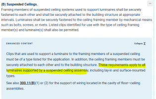

2 wires required on a 2x4 fixture. The ceiling is designed to support the light fixtures. The wires are required for seismic zones and firefighter protection during an event. So basically everywhere in the USA

If I remember correctly (and if I haven't missed a recent code change), additional support is required only when the fixture exceeds a certain weight. Older fluorescent fixtures with magnetic ballasts were almost always heavy enough to require this, but I don't think that most LED lights would be heavy enough. I also remember a provision that an alternate method was to provide additional grid support wires so there was one near each corner of the fixture. NEC 410.36(b) requires fixtures to be securely fastened to the ceiling grid. Virginia is a low seismic area, so it's likely that there are additional requirements for higher seismic design categories.
