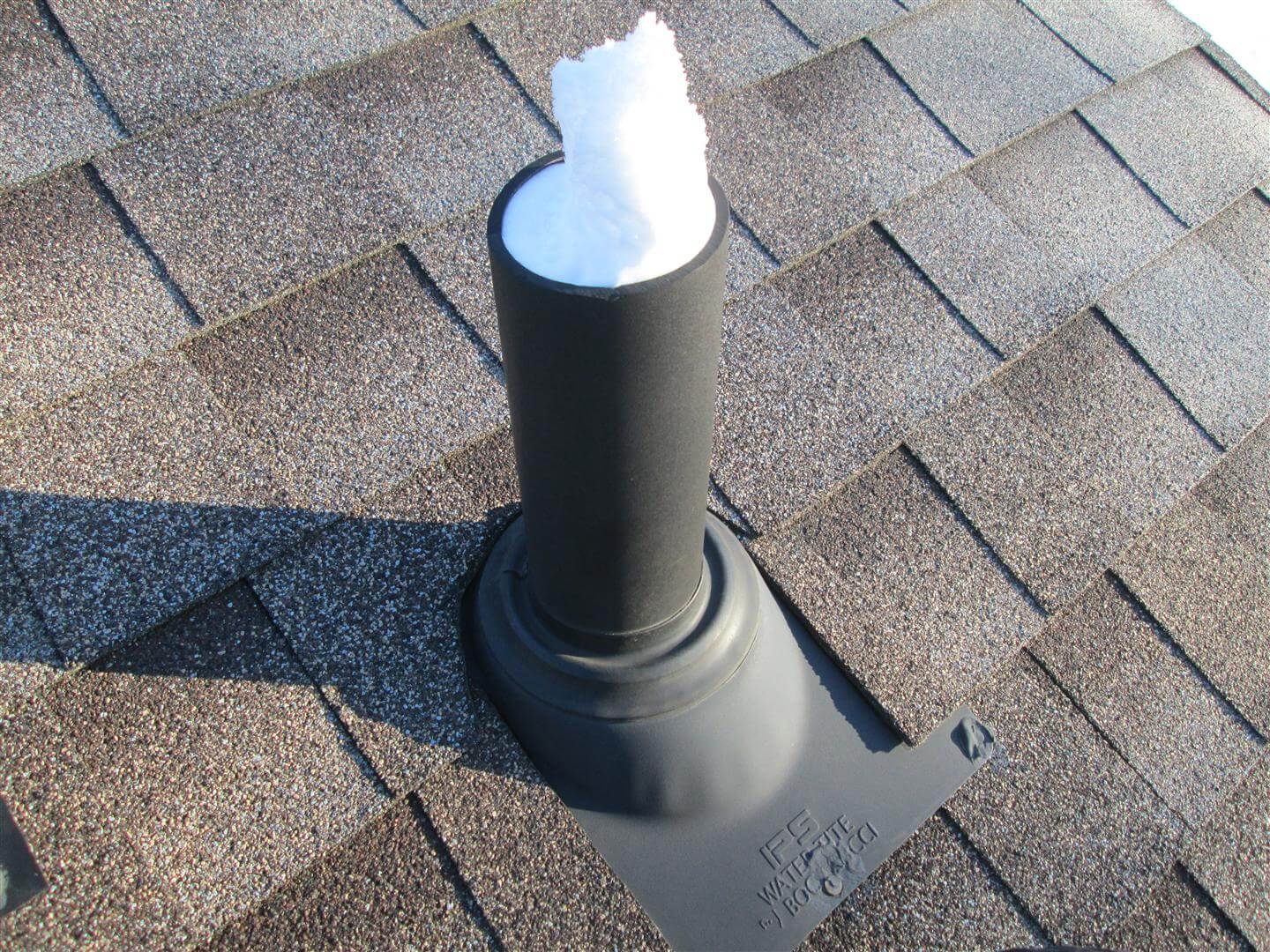

The UPC requires the aggregate area of all vents to equal the minimum size building drain.
A single bathroom with a toilet, lav and tub within a building only requires a 2" vent to service all fixtures so what is the logic in requiring a building with only one bathroom to have a 3" vent?
Does this same requirement exist in the IPC?
IPC Vent sizing....
916.2 Vents other than stack vents or vent stacks. The diameter of individual vents, branch vents, circuit vents and relief vents shall be at least one-half the required diameter of the drain served. The required size of the drain shall be determined in accordance with Table 7 10.1(2). Vent pipes shall not be less than 11/4 inches (32 mm) in diameter. Vents exceeding 40 feet (12 192 mm) in developed length shall be increased by one nominal pipe size for the entire developed length of the vent pipe. Relief vents for soil and waste stacks in buildings having more than 10 branch intervals shall be sized in accordance with Section 914.2.

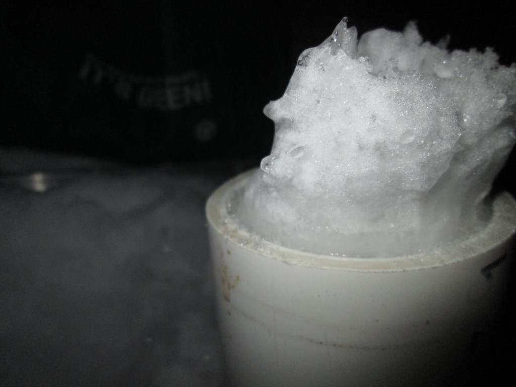

In your climate like mine a 2" vent could frost/ice over in the winter months
retireo9,
The requirement is for a 3" penetration through the roof. The vent can be 2" up to 18" below the roof deck and then bump out to 3".
The reason as shown above is for frost closure.
