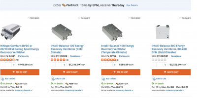

Here is some information on ERV/HRV. Note that the least costly was $450. Of course, there might be better options but my guess is that the typical installation will be a much less expensive fan. It is obvious that a fan with no provision for makeup air will pull air through attics, electrical outlets, window frames, etc. It's all a matter of how well the building is sealed.
"Balanced Ventilation
Tightly built homes and buildings minimize passive air leaks. An exhaust-only fan may create negative pressure. WhisperComfort solves this by supplying air to replace exhausted air, helping to balance air pressure within the home. Panasonic WhisperComfort spot ERV uses two 4 inch ducts - one to exhaust stale air and the other to supply fresh air from outdoors. Its low rate, continuous run ensures chemicals such as volatile organic compounds (VOC's) and other pollutants from cleaning fluids and building materials are vented out and replaced with fresh air."
