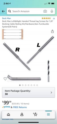

This is the hardware I'm using:
The cable seems to keep stretching.

I understood what you were saying. Im trying to evaluate why the cable is getting slack.
1 cable stretches. Not likely.
2 anchors pulling loose from posts. Possible, you’re using threads into wood and putting a lot of tension on them.
3 cables pulling out of swaged fittings. Also possible, if the fittings weren’t properly installed. Were the crimp dies the correct size for the fittings?

Evening Rick,
1st off not all cables are the same and nor are the fittings.
I strongly recommend either using materials from one of these 2 companies.
I have been doing Cable Railings for over 30 years and these 2 manufacturers do a multitude of different things, but the main thing they do is the quality of the cable they buy and distribute are "Pre Stretched" and as such, eliminates a lot of the continued stretch. Their fitting systems are also way better than all the rest out there IMO. There are a lot of imitation copies, but they are the 2 main stays in the USA. There are a few Sailboat hardware manufacturers that make nice fittings but are a lot longer and harder to work with.
As noted by others, the deck is another issue you will have with pressure treated wood shrinking, I have seen decks and framed lumber shrink about an inch per 15 feet many a times. I had a deck once shrink almost 1.5 inches on 12 feet over 14 weeks after installation of the railing/guard.
If you are sure the wood is not moving on you and it is the cable, I would venture that more than likely the cable is not 1x19 and or not pre stretched.
I am not sure about the fitting you are using, but from what I am seeing posted, the fact that they are left and right threaded and need to be crimped and twisted into the wood to tension and don't machine screw tension like Ultra-Tec or Feeney after being crimped, I would say they are basically a lower quality fitting and that is part of your issues.
I would suggest purchasing one cable package from one of the companies I noted and comparing them to what you did purchase.
1x19 SS cable pre stretched in 1/8" diameter should have no issues under 50 feet

1x19/SS 316 alloy cable in either 1/8" or 3/16" are the staples in the industry and that is a cable that has very limited stretching.
With the stretching keep happening like you are noting, especially older cables like you are talking about, you are more than likely dealing with 7x7 cables and in 1/8 or 3/16 they keep stretching from what I have seen. Sounds like wrong cable and not so good of a connector mixed together.
Here is a link to a wood post cable termination I strongly suggest using when you can't pass through the wood post or into the side of a column or building.
http://eastcoastcablesolutions.com/.../Adjust-A-Body-With-Hanger-Bolt-Tensioner.pdf
Here is a page of assorted connectors from Ultra-tec that are sold by a distributor in MD,
https://eastcoastcablesolutions.com/elementor-147/
In my 30 years of doing cable railings with 1x19 cable, except for green wood decks shrinking, I have never had to go back and re-tension.
Jobs with 7x7 that Architects mandated we use, we always built in plans for service and we would not use 7x7 less than 3/16" also.
But from the new information, I would venture the cables and the connectors are both a problem building on each other.

Mystery solved, a DIY using salvaged material from an unknown source.
