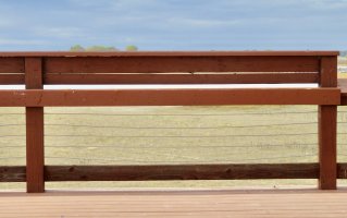

I would not require the guard to be raised if only a component is being replaced. Here is a recent picture of a cable system at a California State Park. Cable systems require maintenance. The tension that's applied to the cable is substantial.
There might come a time when there's not enough adjustment left to take up the slack.
Curious if that cable system save the CA State Park any money vs 2x4's?
I would think that set-up would never meet code no matter how many times Yogi's Park Ranger Smith's goes out to adjust!

The cable and hardware are more expensive than the lumber this would have required. The amount of labor is much greater.
The cable system might have been code compliant for a day or two.
1015.4 Opening limitations. Required guards shall not have openings that allow passage of a sphere 4 inches in diameter from the walking surface to the required guard height.
The issue is not with the cable stretching, it's the wood's shrinkage.
The connectors shown if installed properly will never fully travel the full tensioning distance they are designed for if the projects frame was designed and installed per the limits of the manufacture's specs, which most of the time on wood frames they are not done. So not the cable's fault.

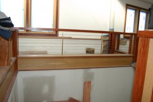

A few examples of installations that passed ASTM E935 Cone Test of 50lbs, though not in the code as a requirement.
The system I have used actually states to install the cables 3" o.c. to address the deflecton issue. Also, there are vertical cable systems that deter kids from climbing. Don't write off cable systems....they allow view and don't have wind loads to deal with like glass.
