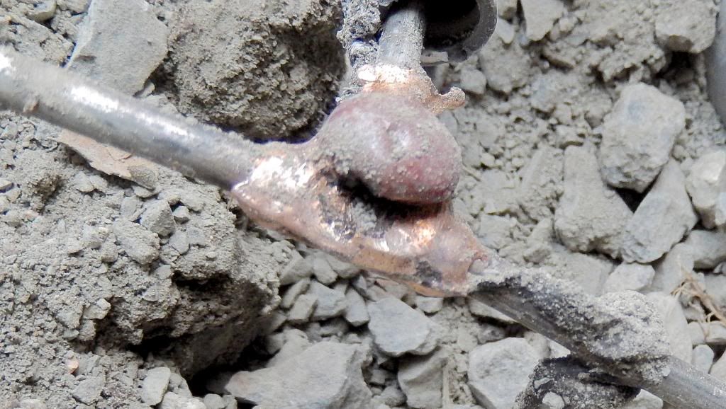

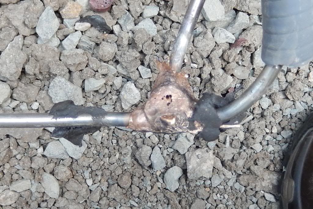

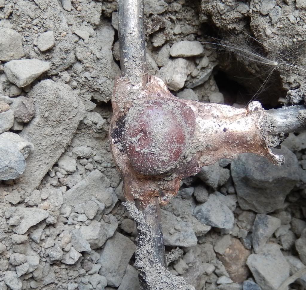

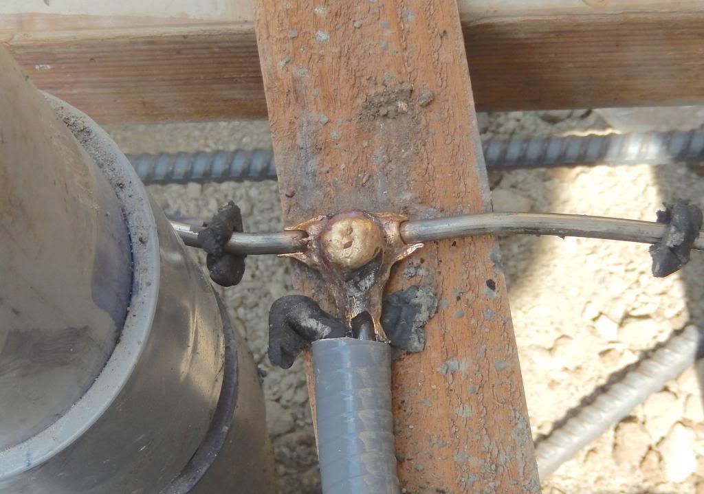

If ugly was a code violation this would qualify. I don't know much about cad welds so I am asking the people with experience whether this is good enough.

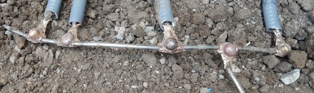

The work is for a cel site ground ring. Everything was buried when I went there this morning so I asked them to expose the six rods and all of the wire and welds.
I just want to know if you think that I should make them do it over because it is too weak.
cad welds need to be fully seated; I'm "certified" in cad welding.. had to take a class to inspect them at a radio place... NPR
Part of the "certification" was to make a satisfactory weld.. a bottle opener to copper conductors..
they are all UGLY, btw

Some of the cad welds look like they are "seated" fairly well,
but some look like they are "over burned" and not seated at
all.
Most of the cellular sites have RDP designed plans & specs.
[ they do here anyway ].........You could contact that RDP
and show them your pics., and ask for a letter of compliance
on each weld, or ask for their guidance on what should be
done to either correct, repair or replace the deficient welds.

Those are fugly.
It looks like the mold was almost worn out or not put together correctly. There are a few that look like the powder wasn't all used as the weld isn't fully formed

Is there a way that a non destructive test be performed to verify that the weld bonded correctly? I mean a x-ray of several of the worst looking ones?
