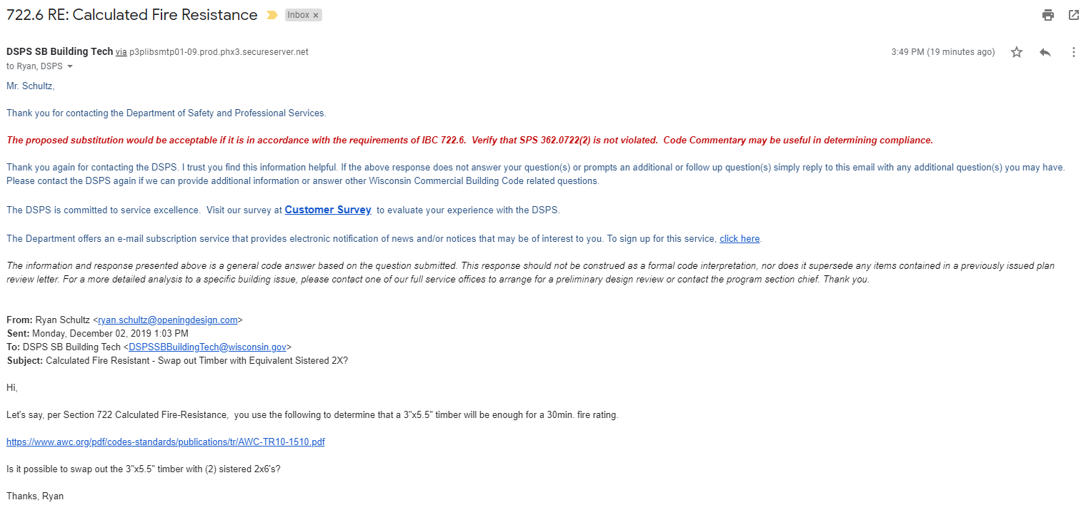

Calculated Fire Resistant - Swap out Timber with Equivalent Sistered 2X?
Heavy timber is just that, monolithic members (they burn "slower than sistered members), not sistered, sistering only works for structural support increases,
AD ... i would agree with your assessment of the slower burn time, but I’m wondering if the is any code that confirms it.
It looks like my AHJ might allow it.
