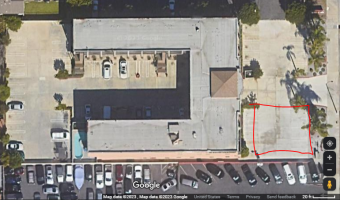

Actual travel distance is very short - -see image below of existing building, and scale in lower right corner.
The red square indicates the new rec room location, which will have a lobby with mailboxes, a manager's office, and also the single accommodation accessible restroom accessed from the lobby. Horizontal distance from rec room to furthest unit is about 180'.
Inside the existing building is a second leasing office that has an extra restroom. A policy could be made to open this up as a 2nd restroom for visitors if needed. If there were that many visitors, they would likely have extra staff on hand to manage it.
