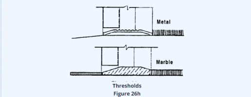

Could you consider the transition threshold, level to the elevator floor track and with slope?
We are trying to avoid a threshold piece if possible.

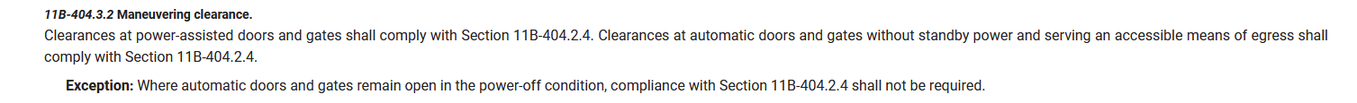

I am a bit concerned about this code section:

As for the link above, the Department of Industrial Relations Title 8, subchapter 6, article 7, subsection 3020 states "...Sills shall be substantially level with the floor surface of the elevator landing or shall be beveled to meet the floor surface,...".
Hopefully this gives somewhat clearer direction as to how to finish the walking surface at an elevator landing even though the verbiage they use, like "substantially", is still subject to interpretation.

Mark, automatic doors seemingly have no maneuvering clearances. Elevator landing requirements are specific to call button areas. Beverly Hills was fine with 5% max as an accessible route.
Because a Building inspector is okay with something does not mean it meets the letter or intent of the code.
You, as a licensed Architect can still end up in court.
Risk/liability assessment....
Mark, I was saying I believe my code analysis is accurate and BH corroborated it. Specifically plan review and this was the only issue they were focused on. The inspector initially raised the issue and I had to address it back thru plan review.
