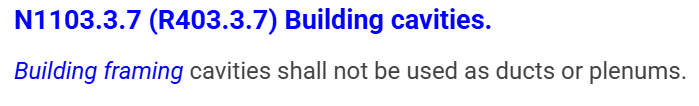

To add another layer, the International Energy Conservation Code (IECC), specifically Section R403.3.5 of the 2015 edition, explicitly prohibits using building framing cavities as plenums in residential buildings (one- and two-family homes, townhouses, and R-2, R-3, and R-4 occupancies up to three stories). While the IECC doesn’t define “building cavity,” the context makes clear that this includes wall, floor, and ceiling cavities not specifically built for the sole purpose of conveying air.
The bottom line: While the IFGC may allow a closet to serve as a return plenum for a direct-vent furnace, all components of the closet must comply with the IMC’s construction standards for plenums. Additionally, the plenum must not utilize structural cavities as return pathways if governed by the IECC. If the installation relies on the wall, ceiling, or floor cavity itself to move air, instead of a dedicated duct or a purpose-built plenum, it is not code-compliant.
