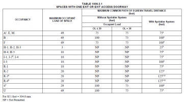

1006.2.1 Egress based on occupant load and common path
of egress travel distance. Two exits or exit access doorways
from any space shall be provided where the design occupant
load or the common path of egress travel distance exceeds the
values listed in Table 1006.2.1.
The project is an open parking garage, total 6 parking tiers including roof parking, occupancy type S-2. It has two exit stairways. However, roof area is only half of the floor plan which makes one exit stairway is not accessible, and roof parking occupancy load is 42 people and based on Table 1006.2.1, two exits are needed - so an exit access stairway is added for the roof level which bring people from roof level to the 5th level. I just want to verify if this exit access stairway can be counted as an exit, so the project is code compliant in this regard. Thanks!

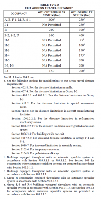

Be certain you are measuring the travel distance correctly. Remember that in a parking garage you have to assume there will be cars parked in the parking spaces, so the exit access route will have to be rectilinearly drawn and measured so that it doesn't pass through any parking spaces. At the exit access stair, the distance is measured along the line of the stair nosings, so take the plan dimension from the first to the last riser and multiple by roughly 1.4.

What you will need to check is the exit access travel distance. In the proposed, you would measure from the mid-point between the exit and exit access on the 6th, to the exit access stairway, along the nosing of the exit access stairway, and to the other exit on the 5th.
2021 IBC
1017.3 Measurement
Exit access travel distance shall be measured from the most remote point of each room, area or space along the natural and unobstructed path of horizontal and vertical egress travel to the entrance to an exit. Where more than one exit is required, exit access travel distance shall be measured to the nearest exit.

1017.3.1 Exit Access Stairways and Ramps
Travel distance on exit access stairways or ramps shall be included in the exit access travel distance measurement. The measurement along stairways shall be made on a plane parallel and tangent to the stair tread nosings in the center of the stair and landings. The measurement along ramps shall be made on the walking surface in the center of the ramp and landings.
Here is the diagram , does the roof level meet the code requirements ?
It depends on the total length of the exit access travel distance from the most remote point on the sixth level. See post #8.
The 110' distance on your diagram is from the bottom of the stair, and is measured on the diagonal, which is incorrect.
I’m wondering why exit access travel distance would be a point of discussion when the entire top level would be within the maximum distance just by using the exit stair on that level.

If the sixth level only has one means of egress, the maximum exit access travel distance is limited to 75 feet.
The top deck has access to more than one exit, but the limit on exit access travel distance is satisfied by any exit within that limit. It doesn’t require measurement to more than one exit.
The issue isn't exit access travel distance. With a single means of egress, the issue is common path of travel distance. IBC 1006.2.1 and Table 1006.2.1.
