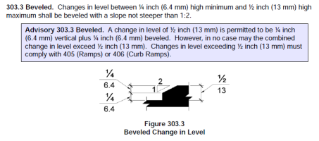

The engineer is proposing to seismically isolate a new stairway form an existing motel exit balcony. He needs a 2 1/2" seismic gap, which means I need to put a 1/4" tall plate cover over it. So that creates a 1/4" high change in level.
I know that vertical changes in level are not permitted on ramp landings (CBC 11B-405.7.1), but I don't see any similar prohibition at stair landings. Is this OK?
This isn't at the nosing. As the sketch indicates, this is a flat metal expansion joint cover at the back edge of the tread, where it transitions to the floor. It's no different than the threshold at virtually every entrance door. If a 1/4" change in elevation is allowed to be square-edged, I would have no problem with a cover that has beveled edges. That's better than what the codes allow.
Yeah....the threshold has a landing on either side....I hate the thought of stepping up to the last tread, hitting your toes on a threshold, having a "1/4" heart attack" and falling back down the stairs.....I'd rather see the plate extend to the nosing...Not saying I wouldn't approve it...I just wouldn't like it...

Not sure why without a deeper look at the actual components the top treads walking surface could not have been designed to overlap the upper floor and cover the joint fully as noted by steveray.
I guess my question is where is this in the process, plan submittal or installed and in place?
If in plan submittal, I would highly question why not look at tread integration.
On the flip side I would agree with cc on the bevel, but what size is this plate?
If the open distance is 2.5", what size is the proposed so called plate? and are there limits on threshold type plates?
So does the design need to accommodate only a 2-1/2" movement horizontally, or does it also have to accommodate a vertical movement? If the stair can move up relative to the existing building, the plate would be in the way, but I guess it could be secured only loosely, or just hinged on one side?
You obviously can't recess the plate into both sides as a rectangular solid, such a shape would have to crumple if the stairs and building moved closer together. It might be possible to recess it as a very thin trapezoidal shape, so that if the stairs and building move towards each other, you'd have two angled sliding planes that push the plate upwards as necessary. Not sure how well that would work in practice, with dirt fouling the sliding surfaces, etc.
Or you could have the seismic gap take a right turn before it emerges out of the landing, and instead emerge out of the face of the topmost riser. The tread and portion of riser above the gap would be rigidly attached to the existing building. Any required vertical movement allowance would show up as a gap in the face of the riser.
