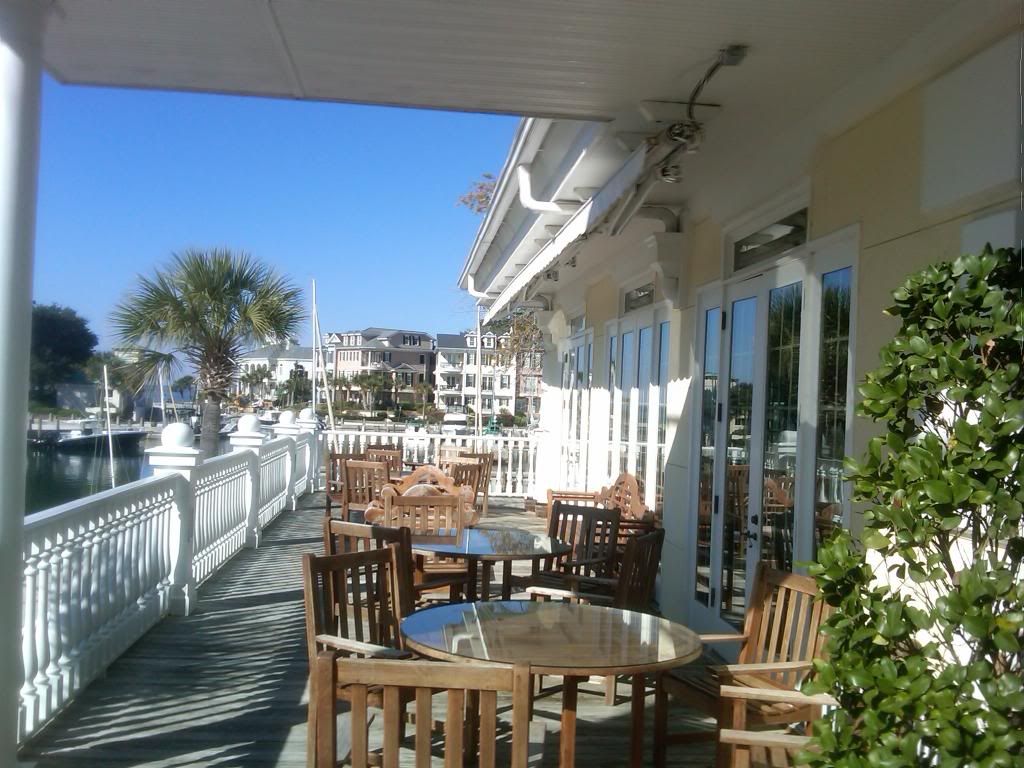

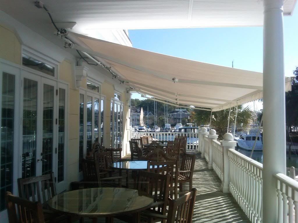

IS this a violation of the Sprinkler Code ?????? The Deck beneath has a walkway below and is protected by a fire sprinkler branch line.
depends on what edition of nfpa 13, the building was built under, and if the canopy is non com.
is the area next to the movable canopy sprinkled??
Most times a picture is worth 1000 words…however in this case it is clear as mud! I do not see the sprinklers or understand your question sorry. If your question is does the canopy need to have sprinkler protection underneath, I would say no. This is a temporary situation and if they did have a fire the canopy would burn off very quickly in the early stages of fire. In addition any sprinklers that will be installed would probably be a obstructed by the canopy… My two cents
First of all thanks for the input...... The building is wood frame with NFPA 13 sprinkler protection though out...... the overhangs are less than 4 feet thus no sprinkler protection along "normal" eaves since they are less than four feet in width. The pendent sprinkler head is just outside of the picture in the first posted picture without temporary canopy extended. Clubhouse was built in 1989 under 1985 SBCCI which referenced the 1983 NFPA 13
How are you going to make the sprinklers work? Those are fabric canopies. If one install sidewalls I see nothing to allow for heat collection and cause the sprinklers to activate.

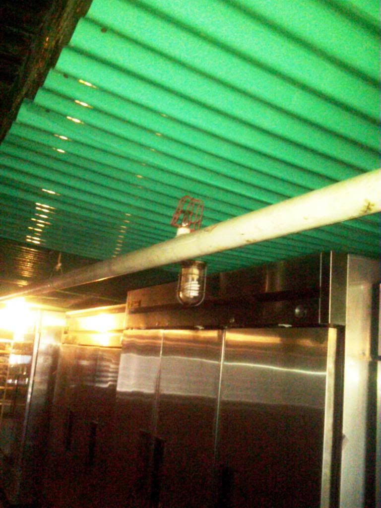

The under deck looks appropriate
Has electrical equipment down there
Hard to tell if good location, freezer goes almost to ceiling
