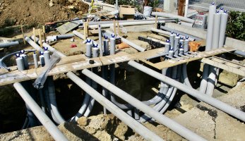

The picture is a portion of the underground conduit required for a bank of EV chargers in a public parking lot. That's not to say that your plan will be as extensive but .... large or small, you need an engineer.
