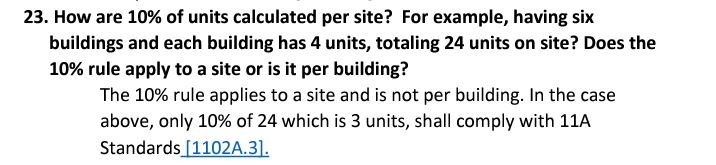

Hypothetical 40 unit private apartment development, consisting of 8 nonelevator buildings, 5 units each, on grade. All units are multistory (2-story townhomes).
CBC 1102A.3.1 says:
At least 10 percent but not less than one of the multistory dwellings in apartment buildings with 3 or more dwelling units and/or condominiums with 4 or more dwelling units shall comply with the following:" (it goes on to list primary entry on accessible route, powder room, all rooms on ground floor accessible, and accessible common area amenities.).
It also says:
The minimum number of multifamily dwelling units which must comply with this section shall be calculated using the total number of all multistory dwelling units in buildings on a site which are subject to this section. Any fraction thereof shall be rounded to the next highest whole number.
Using the last sentence, I determine that 10% of 40 units = 4 adaptable multistory units (AMU). If I disperse them across the 8-building site, that means 4 buildings will have one AMU each, and 4 buildings will have no AMUs, correct?
But wait - - I have 8 buildings, and the exact wording is: "At least 10 percent but not less than one of the multistory dwellings in apartment BUILDINGS...".
So should I calculate it as: 1 AMU per building x 8 buildings = 8 AMUs (not 4), with one AMU in each building?
This has a profound impact on site design, especially on sloping sites where I may be able to place 4 buildings with AMUs + related amenities on a relatively flat part of the site, and place the other 4 buildings with no AMUs on the steep art of the site, where an accessible route will be difficult to achieve.
What do you think?
