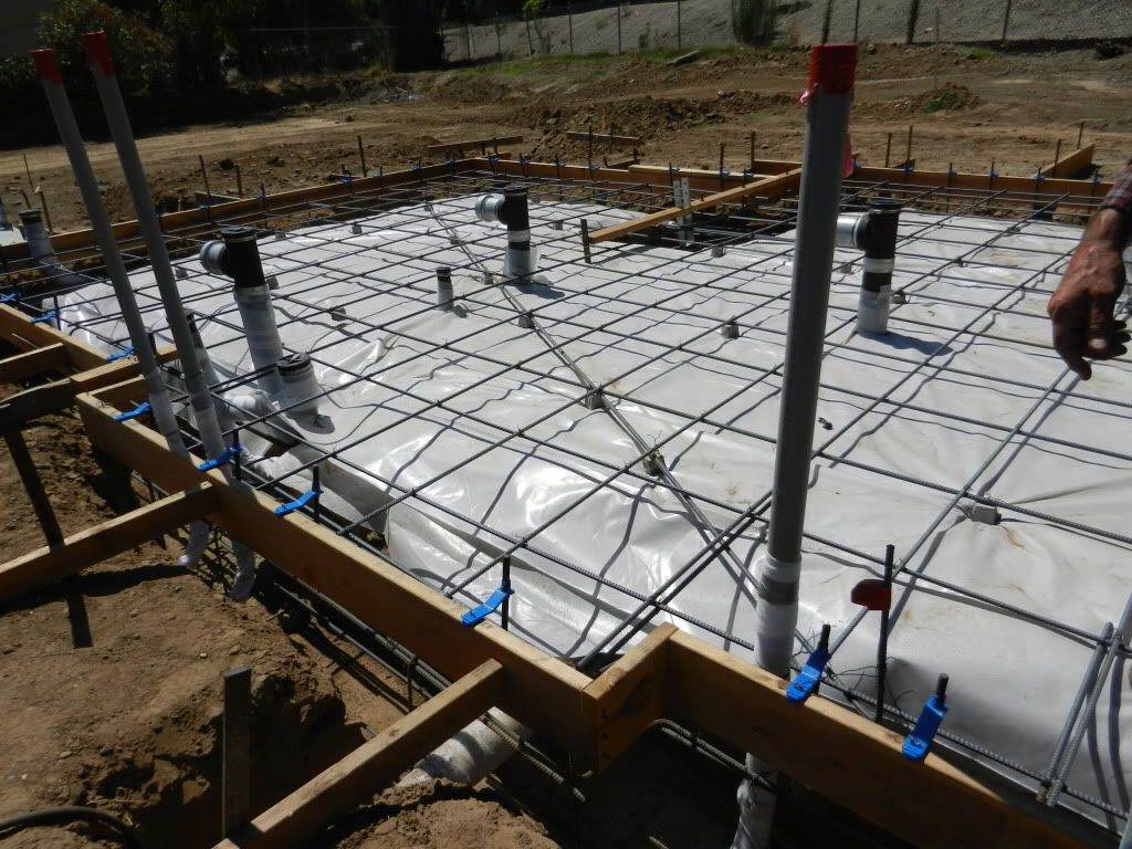

NEC calls for the CEE to be located near the bottom of the footing. It also allows for reinforcing bars to be bound together by wire ties. Given the picture posted - would you require the connection to be made on one of the lower bars, or would you consider this good given all the interconnection of the bars?

Darren,
IMO, I tend to be specific on the requirements of the applicable codes. As you stated,
the NEC DOES require the connector to be located " ...at the bottom or vertically"
[ Article 250.52(A)(3), `08 NEC ].
I would vote for having the connector moved to the bottom to comply with the
requirements, until justification could be provided that would allow it to be installed
' as is ' in your picture. I would also NOT accept a letter from a RDP saying it is o.k.
Show me something in the NEC!
IMHO the connection is fine. The upper re-bar is connected to the lower section by the usual steel tie wires so the actual electrode would be the lower bars and the connection just happens to be on the bars in the upper portion of the footing.
Also the 2011 NEC has removed the term "At the bottom".
Here is what the 2011 NEC says;

Perhaps, this might be resolved if we knew which edition of the NEC
your AHJ has adopted.

Not sure about the connector?.....mmmmm..... Looks like a cadweld to me. I'd say thats a darn good example of a CEE. It may nott be "at the bottom", however, it will be a) below grade b) attached to all the other resteel via ties c) it that stranded copper os 20 feet or more, good to go.
I would have approved the installation in the photo. It meets the code requirement. We also know that the code language was changed in the 2011 to clarify the intent of the connection.

I encountered this one today.
photo #1 - it doesn't look like all conductors are completely in the Cad weld.. photo #2.. where is the copper conductor that goes to the service?
Looks decent from here, I don't see very much stranded either.
