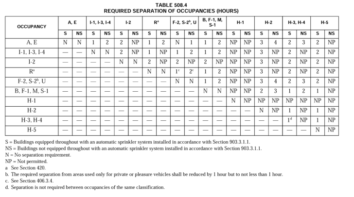

So... Is the ceiling of retail between office one hr? Or exempt?
If retail is code M and office is code B, does Table 508.4 say I'm exempt from needing a fire barrier? No sprinkler in the building.
and I think I read somewhere this applies if you're < 10% of the buildings space, which I am. 5%/6%.

OK, your issue is one of occupancy separation. You said "M" retail vs "B" office, but if the first floor function is a restaurant, then under today's code it is likely an "A" (Assembly) occupancy, not an M occupancy.

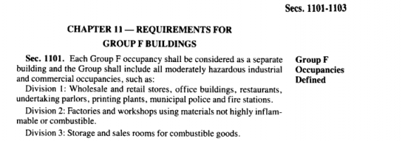

I don't know what code (if any) would have been in effect at time of original construction, but as an example here's an excerpt from the 1928 Uniform Building Code, showing that office buildings and restaurants had the same occupancy classification, which back then was called "F-1":
It is quite possible that under the applicable building code for your building, changing from an office to a restaurant is not considered a change of occupancy.

You didn't name the city your building is located, so I can't be of much more help. But if it were me, I would not start by calling code enforcement, I would call the building department and ask for a meeting with the building official about a potential alteration. Prior to that meeting, ask for a copy of all the records they have on your building especially and certificates of occupancy.
At that meeting:
  • Ask which building code was applicable at time of certificate of occupancy.
  • Ask if their currently adopted codes (which may include the International EXISTING Building Code and maybe some Historic Building Code) will allow the occupancy separations to be based on what was required at time of original occupancy.
