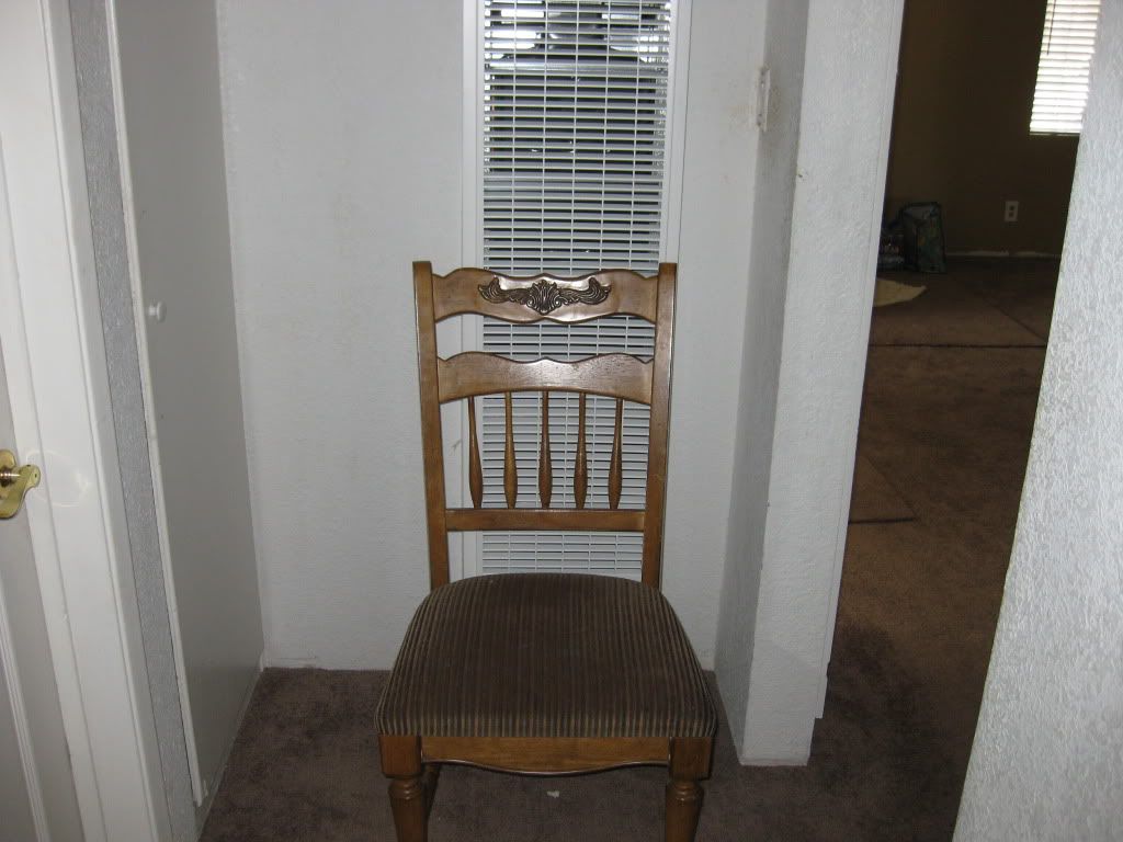

A one man operator met me recently and when I asked him for a ladder he brought me this. The med. sized contractors tell me that it is too expensive to leave a ladder for every inspector. I tried collecting a re-inspection fee. The chief of Mechanical told me that I could not do that until there was no ladder for two inspections. I told him that there have been hundreds with the same three contractors. He told me that every permit is new and they get two.

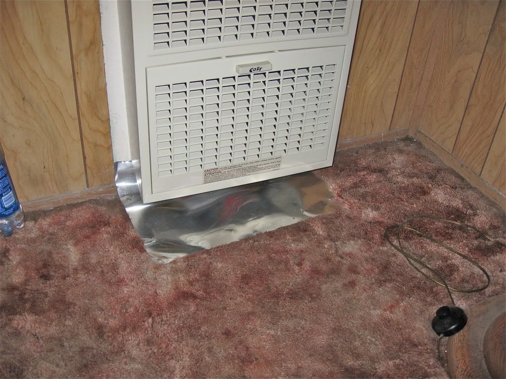

One company did this. I got a little bit angry.
They would do this in a house with kids. So I know it is coming out as soon as I sign the card but what about for the week or three it was here waiting for an inspection. When you called and asked what to do, I told you it had to be permanent. Why do you never do it until I write the correction? Are you hoping I was transfered? If that happens I'll send you a memo.

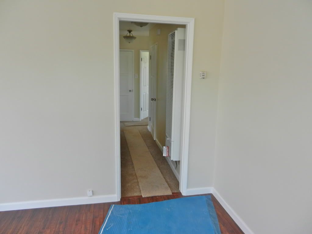

All makers state that the furnace shall not be placed in a hallway or traffic area. They know that these things will burn you. They have been in hallways for years so why change now? The previous furnace stuck out of the wall 2" or 3" and now it's 6" to 8". Perhaps the maker got smarter and the install instructions have changed. I'm not sure but what we allow in hallways is that if the hallway is not reduced below 36" wide from wall to the face of the furnace, it passes. This is another persistent violation and contractors swear I am the only one that enforces it.

That heater sticking out in the hallway is horrible. As for a ladder why not bring your own? Our company uses these nice small aluminum folding ladders that when in the stepladder position come to 7' +/-; they fold up into 4 pieces. For the other stuff, stick to your guns, don't let it slide because 'other people do'. Good luck and don't let it get you down.

As to your wall furaces, I don't like them in hallways either. I would fail your second one in a heartbeat.
