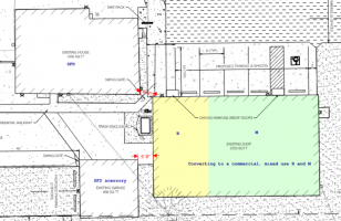

This one is worrying me. I briefly posted about it in another thread but got no bites. Now the mayor is involved. Lots of typical small town backstory but I stick to the code. The following is the process and determinations as I see it, but I am not sure and have a couple of concerns....hence my post. Bear with it if you have the time.
2018 IBC, IEBC, IRC. The existing situation is 1 residential lot, with an SFD, and two residential accessory structures. The highlighted structure is being proposed to convert to a commercial establishment, mixed-use, non-separated, B & M. All wood frame, no sprinklers. Keep planning & zoning out of it by assuming it is approved.
Both the IRC and the IBC would have the applicant establish an FSD, which would be an imaginary line since all one lot. (3rd review, they still haven't done this)
The IEBC has no provisions for IRC regulated structures, but for arguments sake lets call the house an R3, and the accessory buildings U.
First I deal with the IRC, and t302.1(1). Once established, any portion of the SFD within 5' of the FSD would be subject to t302.1(1), therefore the SFD walls and projections (and possibly openings) will need to be rated to some extent depending on where they establish the FSD. (I acknowledge that IRC t301.2(1) may only be considering separations form other IRC regulated structures but it's what I got right now.)
Second I deal with the IEBC, and section 1011.6, t1011.6. In order to use the IEBC an occupancy classification must be assigned for everything. Assuming U for the existing accessory building, and the specified B & M I can use the table to determine whether the change in hazard category is higher, lower or equal.
U to a B or an M is higher, therefore we are directed to the IBC, specifically t602. Since the proposed building is non-separated, I would go with M for my determination using IBC t602.
Using M & VB in t602 I see if there is an FSD < 5' then 2-hr ext. walls are required for those portions, and from 5' to 10' then 1-hr. Combustible projections would be 1-hr where within 5' of the FSD per IBC 705.3.2.
You notice an additional building at plan south. This is the other residential accessory structure, a garage no proposed changes, it will remain an accessory to the SFD. IRC 302.1 includes residential accessory structures for compliance with t302.1(1), so if portions of that building are within the table values assigned, those portions would also be required to be rated. And, since the new proposed commercial building is changing from lower to higher in hazard classification the same separation provisions from t602 would apply and the M would need to used in t602.
So my conclusion, based on the above, is the SFD must be protected per IRC t301.2(1) and the commercial building must be protected per IBCt602.

I am puzzled by the idea that there is no FSD required. I guess I imagined an FSD exists, without a requirement that it be there. -That it is one of the three things in the definition that is always there. If so, then if we imagine the line to be half-way, then everything within X feet of the line has to be rated, but if the FSD ends at the building corner, there is nothing in the way of the right angle measurement, so there is no protection required? In the depiction below neither building is required to have rated exterior walls? That would seem to defeat the purpose altogether.
As for the U classification, the proposed new building is not a U so rate that one as required, but the other building is a U private garage so leave it alone? I like that.
They have to draw the line first...Unless you want to do all the work:

From the original post:
From the OP, clearly shows that it is the shop that is undergoing the change of occupancy.
But the shop exists as an accessory structure to a single-family residence. Once it is converted to a commercial purpose (change of occupancy) it is no longer under the IRC, so the starting point is the IEBC, Chapter 10. Then, if any alterations are being made it will have to be determined which method is being followed: prescriptive, work area, or performance.
Correct... but I think you are missing part of the issue here.
The SFD remains a SFD and is still regulated under the IRC. No change of occupancy as it relates to the SFD.
The shop building, originally accessory to the SFD, is being converted to a commercial building; thus, a change of occupancy is occurring.
The question here then revolves around how to calculate FSD for both the commercial and residential buildings. This is difficult given the lack of separating property lines. Imaginary lot lines have to be used. Further complicating the issue is that the IRC under which it was built required a FSD of 3', but it is now 5'.
Placement of the imaginary lot line for purposes of determining the FSD is going to be critically important for this project.
IMHO, I would suggest that the FSD be placed at the mid-point between the structures. As the SFD is not being modified, I would allow it to remain as is, even if the FSD would prohibit openings or would require a rated exterior wall. As for the shop building, which is now commercial, I would ask that it fully comply with the FSD requirements. If the designer proposed to push the imaginary lot line right up to the exterior wall of the SFD, I would push that the SFD comply with the rated exterior wall and opening limitations.
