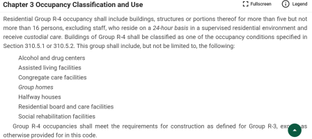

310.5 Residential Group R-4. Residential Group R-4 occupancy
shall include buildings, structures or portions thereof for
more than five but not more than 16 persons, excluding staff,
who reside on a 24-hour basis in a supervised residential environment
and receive custodial care. Buildings of Group R-4
shall be classified as one of the occupancy conditions specified
in Section 310.5.1 or 310.5.2. This group shall include, but not
be limited to, the following:
Alcohol and drug centers
Assisted living facilities
Congregate care facilities
Group homes
Halfway houses
Residential board and care facilities
Social rehabilitation facilities
[BG]CUSTODIAL CARE. Assistance with day-to-day living tasks; such as assistance with cooking, taking medication, bathing, using toilet facilities and other tasks of daily living. Custodial care includes persons receiving care who have the ability to respond to emergency situations and evacuate at a slower rate and/or who have mental and psychiatric complications.

Let's assume 6 or more occupants for the sake of argument (it's less, but knowing the owner I wouldn't be surprised if they try to get more people to fit in the space). What if this isn't a supervised facility. The only employee who's ever on site is a nurse who stops by for 5 minutes to drop off medication. Would that push it to R-4 or would it be R-3? Or R-2.1 maybe?
Not if there is no supervision and care
The halfway house on whose board I served happened to be a mental health halfway house. It is IMHO virtually impossible to imagine housing for people who are in a "treatment program for mental disorders" without there being some level of care or supervision that would trigger the R-4 classification. For this classification to be made, the nature of the treatment program and the exact nature and extent to which it may extend to the residential setting needs to be spelled out in excruciating detail.

Got it. So supervision is the key factor.
What about R-2.1? Would this possibly fall under that occupation (I think R-2.1 is CA specific).
Yeah, I think you're on to something there. R-2.1 is CA specific, and now that I'm looking at it, it does specifically state "halfway houses" and "recovery or treatment facilities".
