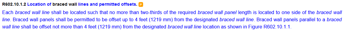

I am not sure where you get the first bullet, "Braced wall lines must be placed on a physical wall or placed between multiple walls."

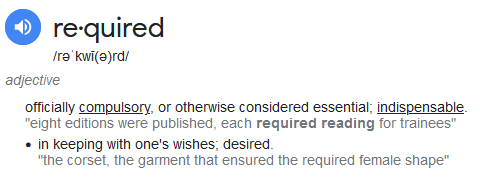

The IRC does require inspection for Chapter 11 compliance, only a portion of which is done by third party. Our jurisdiction even uses different colored permit cards to remind the inspectors which energy compliance path the builder has chosen so they know what to review and the documentation to access.
By a similar analogy, I should not have to bother draftstopping penetrations to my attics because I plan on coating the entire attic floor with 4" of spray foam. They still make me do it anyway. If the code requires something, it is required. The energy code is only different in that it offers 4 different paths to compliance that each have different requirements. Still, many of the requirements are common to all.
