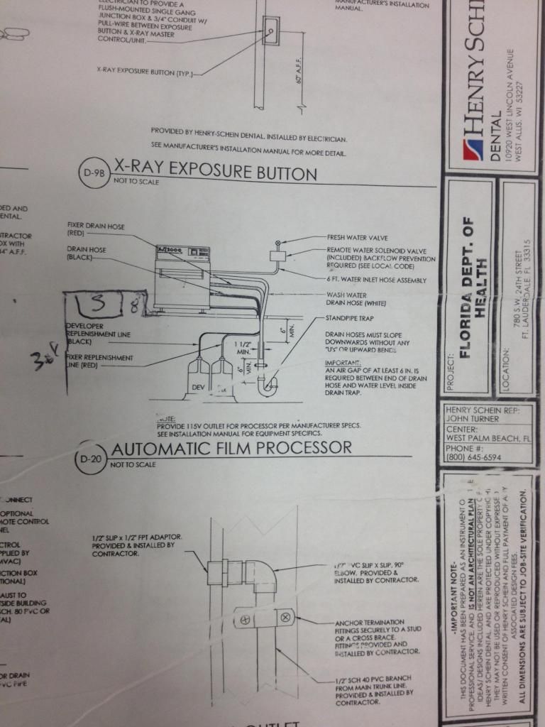

I have a dark room for X-rays that uses a chemical developing solution. There is a supply air duct and a return air grill in a drop/suspended ceiling assembly. This is the first I've seen with no exhaust fan.
Where can I find info on if an exhaust fan is required?
Thanks
I see in IMC 2009 T403.3 that darkrooms require 1 CFM/FT² (thanks Jeff) but is there anything more specific in the IFC?

This is new construction MEP's being roughed in as we speak.

Thats all, as I said I have never done a dark room without an EX fan and wanted to be sure before I have the GC fire off an RFI.
Remember, I'm just the electrician but adding a fan that holds up CO holds up my bosses final payment. This is a county health facility and getting CO's is a PITA so nip it in the bud now.

So is the chemicals in an open tray???
Seems a little strange chemicals are involved and not a digital set up???
Are the chemicals in a machine?? Closed system

Here are the specs;
