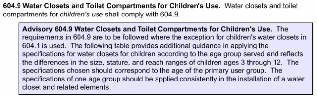

Working on a new Pre K thru 5th grade elementary school and the client would like to use the ANSI child heights for plumbing fixtures, grab bars and toilet accessories only in the toilet rooms dedicated for the Pre K students (5 years old). For the rest of the students they want the toilet rooms designed using standard ADA heights. Is this kosher? I was always under the impression (possibly incorrectly) that that once you choose to implement child height fixtures for one age group you need to consistently apply the child height requirements across the other age groups within the school.
I know there are exceptions but I'm not sure how they fit into the code. Take for example some religious schools which have kindergarten or even preschool through high school. Ivy said a case like that requirements are very different. Hopefully someone else will chime in with the applicable codes.
From projects that I have done with schools, this is a common approach. The gang restrooms are all conventional height with a standard accessible stall. The pre-K and K have a single occupant stall that is installed per the child-height accessible provisions.
In 2010 ADAS 604.1 (exception), children's dimensions for water closets and toilet compartments are optional ("shall be permitted"), not mandatory.
Therefore, IMO you can mix them, using children's dimensions for some age groups, and default "adult" dimensions for other age groups.
The only stated requirement for consistency is within the compartment itself - - the water closet and its related elements. For example, if you choose the age 5-8 category of 12-15" toilet seat height, then you must also choose the corresponding grab bar height of 20-25 inches.

  9. Where toilet facilities are primarily for children's use, required accessible water closets, toilet compartments and lavatories shall be permitted to comply with children's provision of ICC A117.1.
There's a big difference between "shall be permitted to comply" and "shall comply".
Compare "shall be permitted to drive 5 mph" vs. "shall drive 5 mph".
Just to be clear, that was my view as well. Children's provisions are optional.
