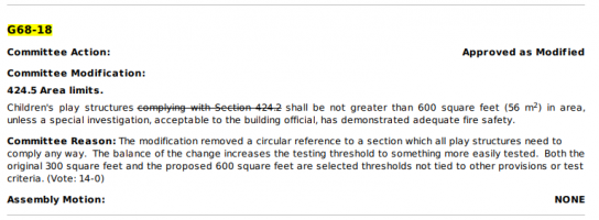

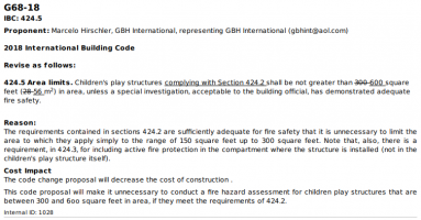

The change from 300 to 600 happened in the 2018 IBC I believe. Here is the BCAC notes:
Not much of an explanation in the change from 300 to 600sf herein.
The change from 300 to 600 sf is interesting. Could you provide a link where I could find the original text? Thank you very much.
Go to the following (2021 code), scroll to Section 424.5, click the Premium Code Insight link for Code Change Details
2018 - https://codes.iccsafe.org/content/I...ed-on-occupancy-and-use#IBC2018P6_Ch04_Sec424
2021 - https://codes.iccsafe.org/content/I...ed-on-occupancy-and-use#IBC2021P2_Ch04_Sec424
If you do not have the premium access, the 2018 Group A proposed changes are available from ICC at https://media.iccsafe.org/codes/2018-2019/GroupA/CAH/IBC-G.pdf. Vote record shows it passed as modified 14-0. See following from https://www.iccsafe.org/wp-content/uploads/2018-REPORT-OF-THE-COMMITTEE-ACTION-HEARING.pdf.

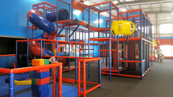

How to define play structures? I have large area left empty to place loose toys. The actual space occupied by fixed play equipment is less than 600sf. Maybe the 2021 rule will apply in my case.
I think you know a play structure when you see it... but it is defined in the IBC.
[BG] PLAY STRUCTURE. A structure composed of one or more components, where the user enters a play environment.
If it is a play area with toys, I would not assess that it is a "structure".

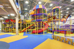

I am thinking something like this. Do you call it play structure? Does any of the 424 section apply?
The small play-related, scaled-down buildings would be play structures (they can be entered). The bus, firetruck, and table would not be IMHO (played on/with, but not entered).
Keep in mind the scoping statement of Section 424. 10-ft tall or >150sf in area will need to comply with 424. The material specifications in 424.2 is probably one of the most important items to consider IMHO.
