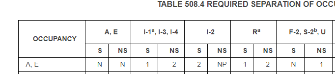

I have a school addition, separated from the existing school by a fire wall, that is mostly vocational, about 90% of the area is diesel, welding, and agricultural shop. Due to the size of these uses, they would not be considered incidental to the E, in fact they are the reason for the E. If it is all an E, and none are incidental, then would 509 apply? I ask because they are providing smoke construction as required by 509.4.2, but falling short with door hardware and smoke dampers. If it isn't required to comply with 509 I wonder if it matters. 2021 IBC.

The building works as non-separated for everything but the H2, and I'll eat my shorts if that is what it ends up being. Using E and incidental is actually more restrictive because of the smoke walls, door operation and smoke dampers.
Yep....I would go about it backwards...The uses are already declared/ accounted for, therefore not incidental...But same result
I disagree. Section 509 applies because it says it applies. It doesn't say to NOT classify the shops as Use Group E, but it recognizes the potentially higher fire hazard created by the subjects being taught and therefore requires additional safety features.
That's the point.
Yep....E and F2 for metal fabrication requires no separation (assuming sprinklers):
So again....not "incidental use" declared use, mixed, non-separated.......
