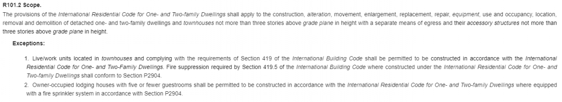

2015 IBC [A] 101.2 Scope. The provisions of this code shall apply to
the construction, alteration, relocation, enlargement, replacement,
repair, equipment, use and occupancy, location, maintenance,
removal and demolition of every building or
structure or any appurtenances connected or attached to such
buildings or structures.
Exception: Detached one- and two-family dwellings and
multiple single-family dwellings (townhouses) not more
than three stories above grade plane in height with a separate
means of egress, and their accessory structures not
more than three stories above grade plane in height, shall
comply with the International Residential Code.

Can someone give any justification as to how this is a SFD when the known intent is to house ranch hands? This meets the definition of a boarding house, but does not meet the IRC's scoping as given by R101.2.
