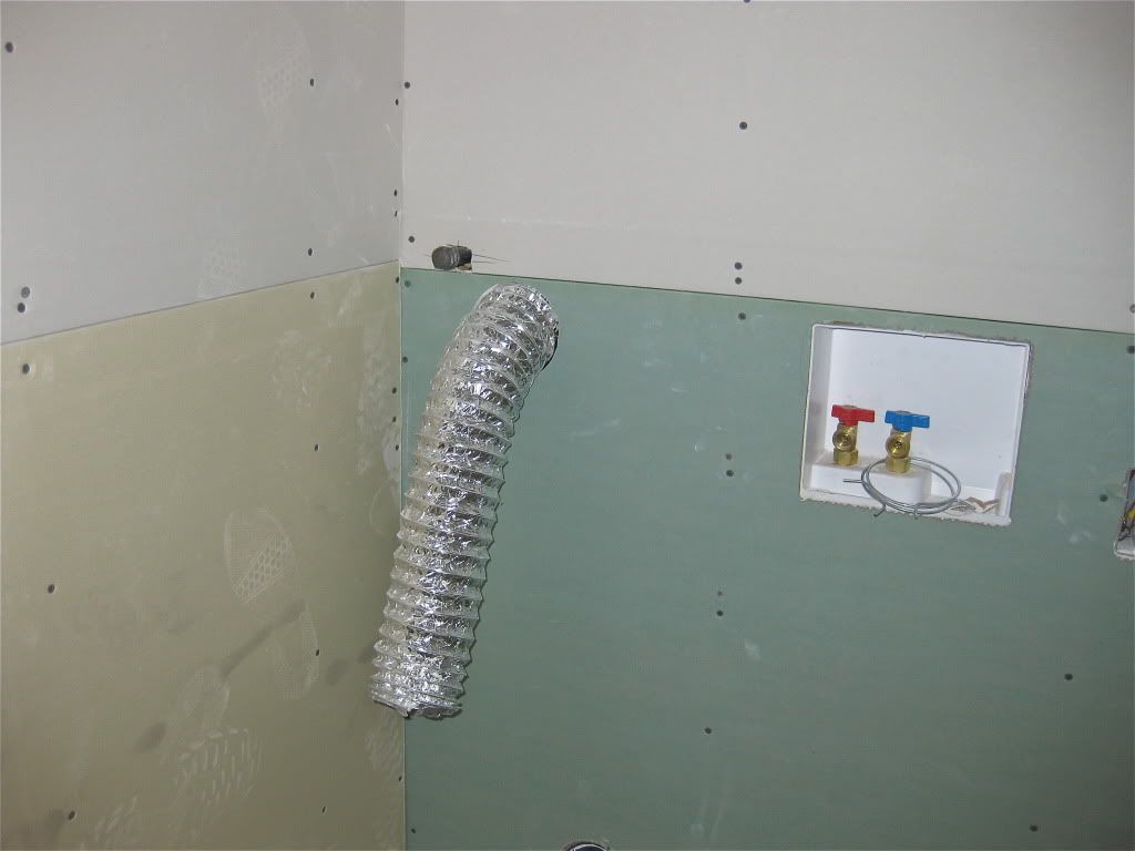

I recently realized that semi-rigid ducts are not UL 2158A listed. This is where I run into a problem. Most manufactures allow for the use of semi rigid transition ducts, but do not allow for plastic (vinyl) or foil flexible ducts.
Both the mechanical section and the fuel gas section of the IRC read similar when dealing with clothes dryer exhaust. First, it states that the dryer shall be exhausted in accordance with manufacturer's instructions. Then it goes on to talk about materials, runs, equivalent lengths, etc....
Where I run into a problems is that the manufacturer's instructions say nothing of UL-2158A and allows use of a semi-rigid transition duct which doesn't meet the requirements of the code. I have required that many flexible duct be removed and replaced with semi-rigid ducts based on what I have seen in installation instructions. About a week ago I realized that these semi-rigid transition ducts do not meet UL 2158A.
So, how do you handle it when the code contradicts itself in M1502 and G2439? This can also become an issue when dealing with maximum length.

Mike there is no contradiction, there are two separate issues.
One is Transition Duct. IFGC 614.6.4 and IRC G2439.5.4 limiting a single length to eight feet.
Two is the dryer exhaust duct IFGC 614.6.2 and IRC G2439.5.2 limited to 35 feet which does not include the transition duct.
A lot of transition ducts on the market do not have a UL 2158 listing and do not meet the criteria and should not be used.

M1502.4.4.1 and G2439.5.5.1 are default measuements to be used where the manufacturers instructions are unavailable. Hence the last sentence in both of the .2 parts.
The Codes are silent on the transition piece and only address the duct proper - the concealed part. The transition is only the (typically) short piece from the back of the appliance to the concealed duct.

614.6.4 Transition ducts.
Transition ducts used to connect the dryer to the exhaust duct system shall be a single length that is listed and labeled in accordance with UL 2158A. Transition ducts shall be a maximum of 8 feet (2438 mm) in length, and shall not be concealed within construction.
ICE said:
This is a UL 181 duct, it is limited to a maximum temperature of 250 degrees F. Depending on the thermal override the dryer manufacturer uses the exhaust temps could range from 200 degrees F to 350 degrees F. That is the reason the duct connector needs to be UL 2158A to meet the temperature requirements. There are numerous products that meet UL 2158A and readily available at the local hardware or the big blue or orange box stores.

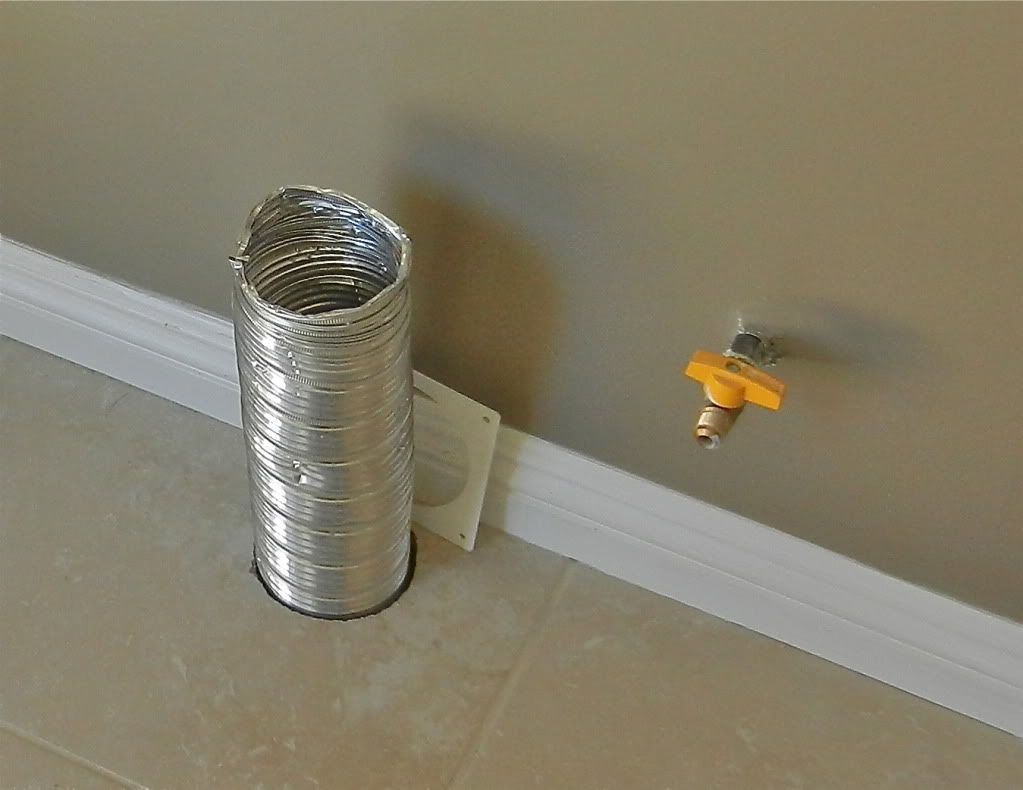

Okay, maybe I am just reading too much into this.Here is a picture of three types of transition duct. The top one is listed in accordance with UL2158A and appears to be foil, which is not allowed by any manufacturers that I have found. It doesn't appear to qualify as a semi-rigid duct. The middle is what I consider to be a semi-rigid dryer vent, which is the same as ICE posted earlier in this thread. The is the type that I preferred to see based on what the dryer manufacturers print in their manuals. The bottom one is obviously a cheap foil duct.
/monthly_2013_11/572953cf3b4e3_3-types-of-flexible-duct1.jpg.f1f83b3e20fb1155e1cbebf171fb659a.jpg
None of those qualify as dryer duct that can be concealed within construction. I don't know anything about UL2158A but apparently it doesn't require much in the way of strength. If the duct wall is so thin that it could be damaged by a duct brush, it's not good enough.
