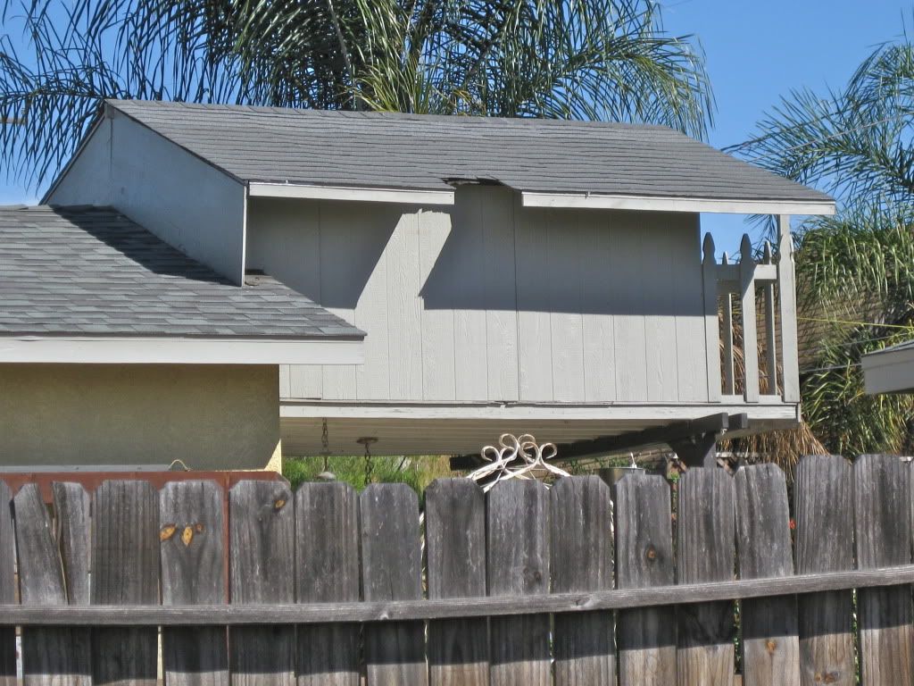

I turn a blind eye to most of the bootleg stuff that I come across. Not because I think that's a good attitude to have but because I really have no choice. It is everywhere. I only go after the complaints and what I stumble into if it is dangerous.
Here is a bootleg patio cover that has morphed into a play room.
Turning a blind eye is dangerous, and in fact, constitutes nonfeasance.
You would be wise to serve notice and document the violation. If the mechanisms in your jurisdiction do not aggressively pursue violations, so be it.
chris kennedy said:
Why does it look like someone bit part of the roof off?
It's right next to Jurassic Park. Truth is I don't know. I can see that the fascia has been cut, not broken. I turned it over to code enforcement so I don't know any details. It's a tear-down so there's nothing for me to do.
Tooth gnashing marks from the owner after being told the building has to come down.

I don't like converted garages. A few times each year, one goes up in flames and somebody dies. When I find them, I check them to see how scary dangerous it is. Many are no big deal and too many are death traps. The one that is the subject of this thread came to me as a documented complaint, so no matter what I think, it goes away.
