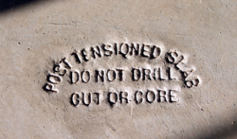

I've seen images of concrete slabs that are stamped with an identification that they are post-tensioned.
I'm wondering if this stamp is a code requirement, or simply best practice.
I'm helping a multifamily client make their podium building ADA accessible, and it involves coring into the concrete deck for new waste lines. The edges of the slab are not visible, so I can't use that as an indicator.
Before we pay for GPR testing: Would the absence of a PT slab stamp be a relatively safe indicator that the slab is not post-tensioned?

No but it should be
Where would the stamp be placed so that it always visible?
Trust but verify, if you are unsure the cost of testing is probable cheaper than the fix.
Garage floor. I thought that it was required and I have required it... a bunch of times without complaint. I think that I will continue to require it. The few times that a tendon was cut they were dumbfounded that there wasn't some warning.
