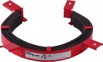

The pipe plug is NOT a fire-stop system.
A fire stop system is something like this:
It's a recipe of sorts.
