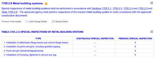

I'm mentioning this because special inspections for PEMBs has been added to the 2024 IBC, as section 1705.2.6. As states and jurisdictions begin to adopt the 2024 I-Codes, this is one of the changes to be aware of.
