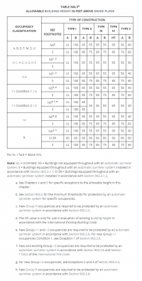

On a commercial building what would be the maximum height requirement to consider it one story? If I go past a certain height would it be considered a 2 story building?
Yes the whole roof will be removed and made higher. The city only requires a small amount of building to remain to consider it a remodel.
