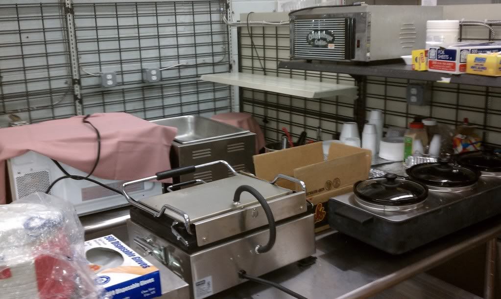

How does your jurisdiction handle situations like this if the IMC applied?

Have not called for electrical inspection yet. Still waiting on a transformer to get delivered. GFCI protection a must because they are all kitchens serving food to the public.
Not sure the Health or Fire Dept would approve. Electrical would be the main focus unless there's some other cooking unit I'm not seeing.

I would not require the Type II hood! I would however, focus on the electrical and
certified, portable fire extinguishers. The Health Dept. can / should handle any
type of food prep / serving / refrigeration / cleanliness issues.

A hood may not be required to directly capture the odors and fumes but it does require mechanical ventilation in that area/space.
I would not require a hood. Not sure whether i agree with that or not, but it is what has been handed down from those who control the code in NY.
Those appliances are 110V, and the only appliance that might require an exhaust system would be the 2 burner range, and then only if they are cooking grease producing food. I have an account with the small grille, used to cook hamburgers and there is steam, but no appreciable amount of grease vapor.

Most health departments are looking for a smooth, non absorbent SURFACE so it can be cleaned... I don't know that I'd say the jail bar/re-bar configuration is going to comply with that.
Steam is the biggest byproduct, probably.. I probably wouldn't require a hood of any type.. but it doesn't look done.
Since the State of Minnesota heavily amends this section, I had to go back and look at the IMC (2006) and would agree that a hood is not required. Minnesota adopts NFPA 96 for Type I hoods and exhaust systems and writes in our own for Type II. We require Type II hoods to be installed where cooking or dishwashing appliances produce heat, steam, or products of combustion and do not produce grease or smoke, such as steamers, kettles, pasta cookers, and dishwashing machines. There are four exceptions. Of particular interest relating to this post are exception 3 & 4. Basically, counter top type appliances rated at 3.7 kW or less are allowed without the hood, as long as the additional heat and moisture loads generated by such appliances are accounted for in the design of the HVAC system. The HVAC system must be able to maintain a maximum relative humidity of 65 % in the space. Here's a link to a pdf file regarding Minnesota Commercial Kitchen Ventilation Guidelines. It is not a code book, but may be helpful to some people regarding the ventilation concerns for kitchen design.

We use the 09 codes, where the term "grease vapors" has been removed. Instead, the code now specifically defines light and medium duty appliances making everything much easier. less gray areas. If the appliance is defined in chapter 2 it needs a hood. Simple as that.
