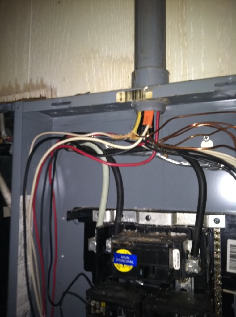

Called in for a renovation and found the following:

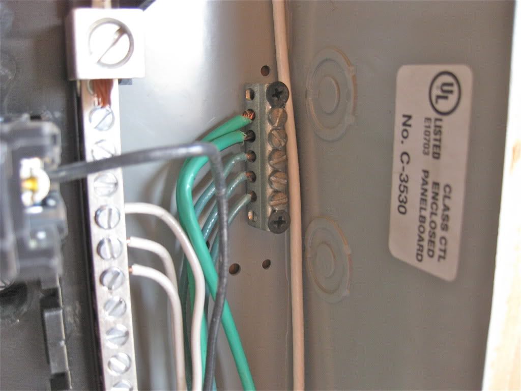

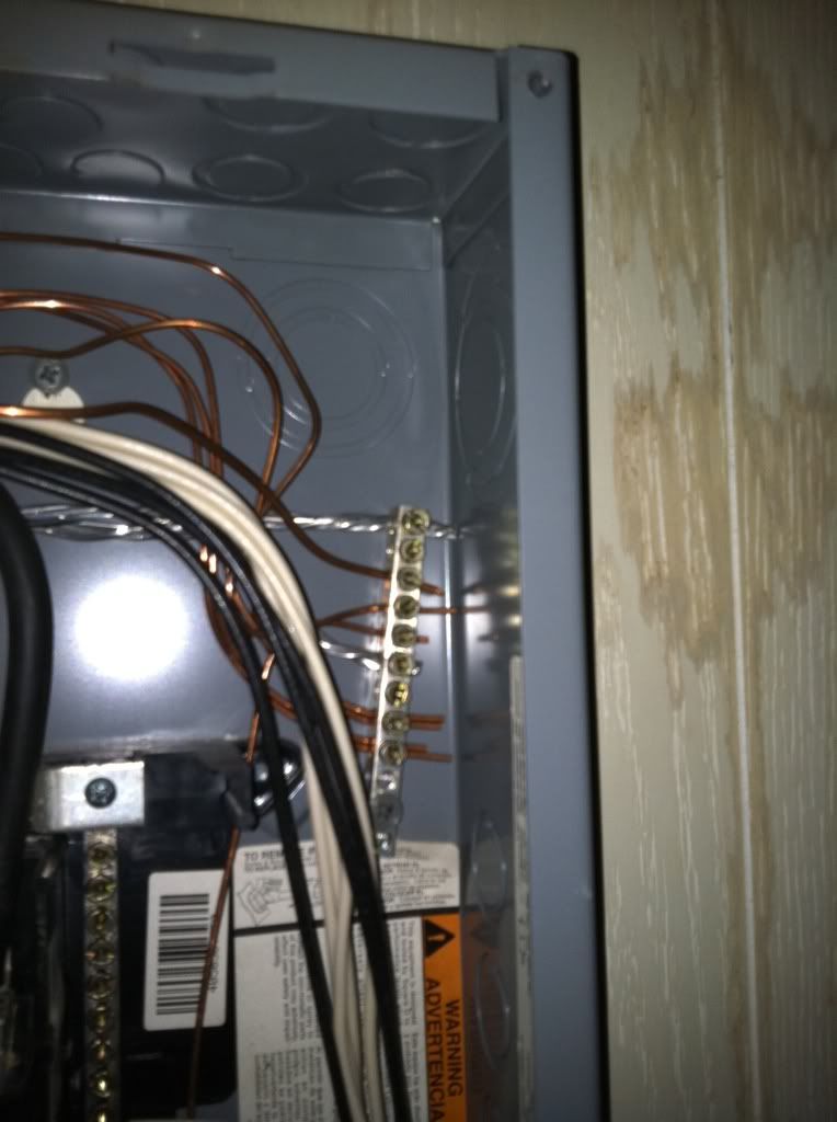

First noticed this in the sub panel. Yes, that is a drywall screw holding in the grounding bar.

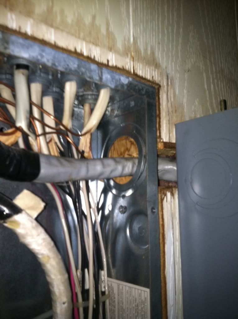

Then noticed this nice feeder to the sub from the main:
Then this conduit with newer NM-B cable that fed to above the drop ceiling in this proposed M occupancy:
There should be two screws and the paint removed behind the bus-bar. ;)
I see drywall screws used to secure panel cabinets, windows and hardware.
