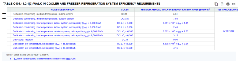

How is everyone verifying compliance with this section?
C403.11 Refrigeration equipment performance.
Refrigeration equipment performance shall be determined in accordance with Sections C403.11.1 and C403.11.2 for commercial refrigerators, freezers, refrigerator-freezers, walk-in coolers, walk-in freezers and refrigeration equipment. The energy use shall be verified through certification under an approved certification program or, where a certification program does not exist, the energy use shall be supported by data furnished by the equipment manufacturer.
Exception: Walk-in coolers and walk-in freezers regulated under federal law in accordance with Subpart R of DOE 10 CFR 431.
C403.11.1 Commercial refrigerators, refrigerator-freezers and refrigeration.
Refrigeration equipment, defined in DOE 10 CFR Part 431.62, shall have an energy use in kWh/day not greater than the values of Table C403.11.1 when tested and rated in accordance with AHRI Standard 1200.
C403.11.2 Walk-in coolers and walk-in freezers.
Walk-in cooler and walk-in freezer refrigeration systems, except for walk-in process cooling refrigeration systems as defined in DOE 10 CFR 431.302, shall meet the requirements of Tables C403.11.2.1(1), C403.11.2.1(2) and C403.11.2.1(3).
I think the "problem here is there is no longer a prescriptive way to site build a walk-in cooler unless you want to accept energy calcs from a designer? Near as I can tell it is all a DOE standard but at least it gives you energy usage that none of us will figure out:
2021 IECC
C403.11.2 Walk-in Coolers and Walk-in Freezers
C403.11.2.1 Performance Standards
Walk-in coolers and walk-in freezers shall meet the requirements of Tables C403.11.2.1(1), C403.11.2.1(2) and C403.11.2.1(3).
