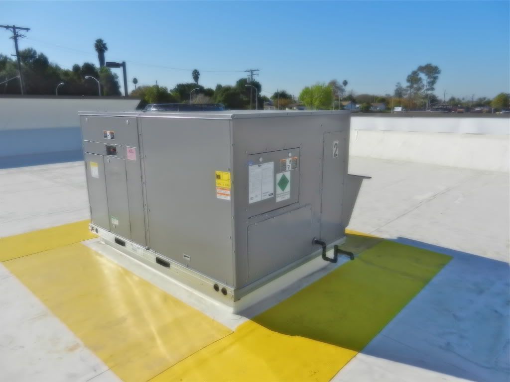

From the NEC210.63 Heating, Air-Conditioning, and Refrigeration Equipment Outlet
A 125-volt, single-phase, 15- or 20-ampere-rated receptacle outlet shall be installed at an accessible location for the servicing of heating, air-conditioning, and refrigeration equipment. The receptacle shall be located on the same level and with 7.5m (25 ft) of the heating, air-conditioning, and refrigeration equipment. The receptacle outlet shall not be connected to the load side of the equipment disconnecting means.
There are a few important points to mention here. First off, a hvac equipment outlet is required no matter where an hvac unit is located. This means that whether the unit is mounted on the floor, in a closet, in a ceiling, is exterior pad mounted or roof mounted, this code is required.
The next thing of importance is that when a service receptacle occurs in an exterior location, it must be GFCI protected per 210.8(B) and have a weatherproof enclosure per 406.9

Msradell said:
I think the condensate onto the roof is a local issue not a code issue any place I've ever checked. On the other hand the 120v receptacle is required to be on its own dedicated circuit so it's able to be used for servicing while the unit is out of service.
ICE said:
While all of this is correct, your first statement is incorrect. ("On the other hand the 120v receptacle is required to be on its own dedicated circuit so it's able to be used for servicing while the unit is out of service.") There is no requirement for a dedicated circuit.
Since 210.63 requires that the receptacle shall not be connected to the load side of the equipment disconnect and this type of equipment, in anything other than residential service utilizes power feeds greater than 120 volts (usually 480v) then meet the requirement is going to necessitate providing a separate service for the receptacle.
\But not a dedicated circuit.
