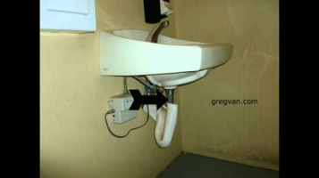

Must pipe wrap completely cover exposed "P" drain beneath the sink? Can it be held back (see photo)
Yes the pipe wrap must completely cover exposed "P" drain pipe.
any portion can cause burns to legs of chair users and any abrasive areas can cause cuts or abrasions to legs.
Burns can only occur if contact is maintained for a period exceeding 3 minutes @ + 130 degrees. Cpc requires metered delivery for 25 seconds at no more than 120 degrees. If only 3/4" is exposed why is that not. OK? Also the connection to drain is clear of the minimum clearance reqd.
606.6 Exposed Pipes and Surfaces. Water supply and
drainpipes under lavatories and sinks shall be insulated
or otherwise configured to protect against contact.
There shall be no sharp or abrasive surfaces under lavatories
and sinks.

Steve as I then see it, around vertices drain a as shown could not be assumed to have exposed edges and as much as 1-2" could be exposed .
