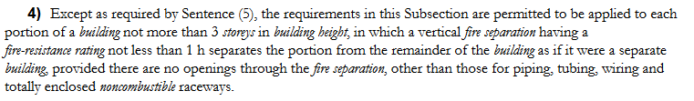

I have a building that is F-2 on ground floor with residential above.
Is the intent of sentence 4 "as if it were a separate building" to dis-allow occupancies on top of one another? In other words, a horizontal fire separation between the occupancies would be prohibited?
Happy Friday
Yes, the exception would only apply to occupancies separated by a vertical separation. In theory, a horizontal separation would pose a greater risk for fire spread from the occupancy below to the one above and thus not able to take advantage of the same relaxation in the code.
Thanks, I agree.
