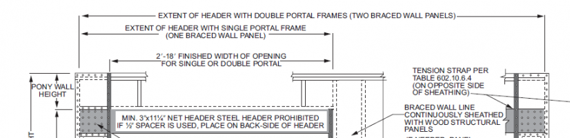

Continuously Sheathed Portal Frame
Kao Chen
Member
Oct 23, 2009
28
Lake of the Ozarks, Missouri
2012 IRC Section R602.10.6.4 & Figure R602.10.6.4.
The length of the header is simple per Fig. R602.10.6.4 for a continuously sheathed portal frame panel if using a single garage door but how do you translate this into a two garage door set up in the same wall. Do you have one (1) long header over both doors or separate headers. Code is not really clear.
Thanks for your input.
