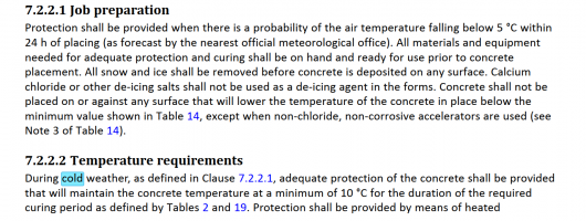

CSA A23.1
Inspector Gadget
Mar 5, 2020
785
New Brunswick
Hey folks. I'm looking for the specific reference that requires concrete in Part 3 buildings to be kept to 10C if the ambient temps are below 5C. It's a section of CSA A23.1 ... if someone can dump text/screen capture, I'd much appreciate it.
