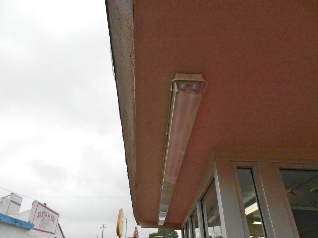

12" to 24" from the edge of the overhang.
You will never get a clear answer on that. IMO it would depend on how high the overhang is from the outlet. It would be a big difference if the overhang were on the second floor. Basically I look at it and decide if rain is likely to get in the outlet. I also don't think that it should be interpreted to mean if it can ever possibly get wet.
The problem is that it is an AHJ call and really not a call that can be made based on code wording. 24" overhang I would probably use a wet location however if it was on an adjacent wall and 24" in I would not feel the need for a wet location cover.
Hey Dennis,

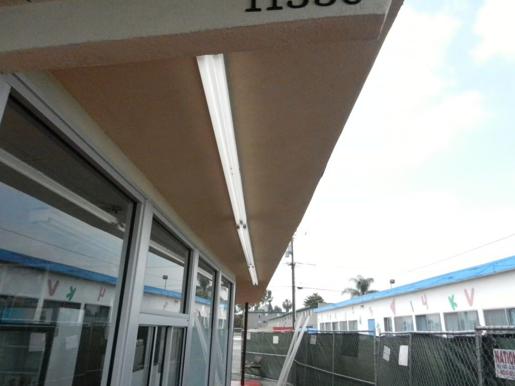

Actually, it is the light fixtures that I wonder about. They are listed for a damp location. I made the call that this is a wet location and I wanted to hear what you guys thought. In a light rain there wouldn't be a problem but a little bit of wind would change it up.
The other thing that I noticed was a lack of a sleeve or cover on the tubes to stop raining glass.
Here is the definition. Damp location does not mean it will not have some moisture.
Location, Damp. Locations protected from weather and not subject to saturation with water or other liquids but subject to moderate degrees of moisture. Examples of such locations include partially protected locations under canopies, marquees, roofed open porches, and like locations, and interior locations subject to moderate degrees of moisture, such as some basements, some barns, and some cold-storage warehouses.
The cover over the tubes is not an electrical code issue but I don't know about building code. I know over food prep areas it is necessary but never heard it necessary outdoor as such.

When the issue first came up, the GC stated that the electrician had noticed this and advised that it might not make it as a damp location. The contractor changed the fixtures and was convinced that it was a good idea.
I told him about the unanimous forum vote for a damp location. He said that you really need to see it in person to get the full effect and he had no doubt that the fixtures would get wet. He also said that the peace of mind was worth the cost.
damp locations occassionally get wet, but it's not the typical condition (unless you have reverse gravity). A wet location is always subject to rain (like a typical exterior light at houses) - and I've seen interior lights installed there, too (until we make them change it).
Measure the distance of the horizonal projection from the outside wall, then measure that distance down the outside wall from the horizontal projection. Connect the two and anything in that area is a damp location. JMHO
