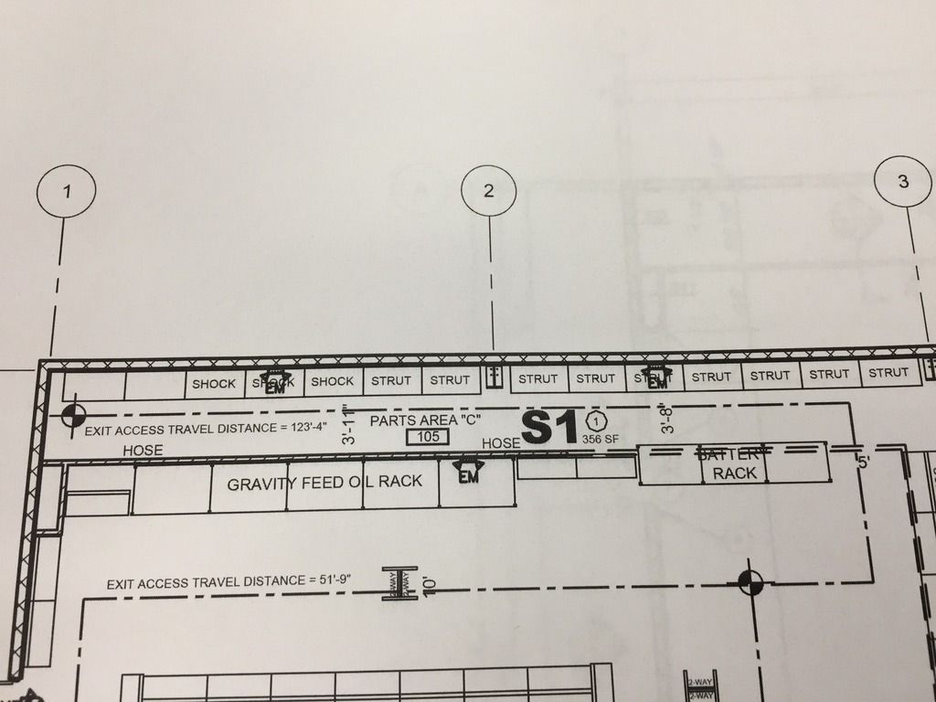

New auto parts store, would you folks call this a dead end for egress purposes? I believe it is bounded by exterior wall on one side and full storage racks on the other up to a soffit (think those gravity feed oil container racks) with no real openness....Thanks!
I assume those are radiator hoses and the like on the South "wall" of oil containers...No hose nozzle...I don't think I can call it a room if it is 4' wide..
No sprinklers, CPET is <75, so that is OK. I some people view corridors as strictly traditional walls, but I am not sure I agree with that approach...
CORRIDOR. An enclosed exit access component that defines and provides a path of egress travel to an exit.
I agree it is a common path of travel requirement first. If the common path of travel from the remote point of the room to a point where two different means of egress can be taken is exceeded then the back room will require another means of egress from the backroom. If it is under the common path of travel distance then there is no problem. Also if from the remote point of the room the travel distance to an exit is in compliance; then the larger space would need two means of egress because at some point out of the back room the common path of travel going into the larger space will be exceeded and two means of egress will be required.

1020.4 Dead ens. Where more than one exit or exit access doorway is required...
First question I have is 'how many exit or exit access doorways are required?'
From the building, 3......From that spot, 1. But if that was the intent you would never have a dead end because you would always have to meet CPET? and why would dead ends be a lesser distance than CPET?
Because once you hit the dead end
You have to back track
Adding time and distance to getting out
  • Like
Reactions: JBI
Dead ends are a lesser distance than CPET because CPET includes the distance from wherever you are in a building, while 'dead ends' are specific to corridors and not sending people in a direction they can't egress from. Calling a long narrow storage room a 'corridor' is, at best, a stretch of the imagination.
From the remainder of the occupancy, are there exit signs directing anyone to egress through the storage room?
If so then you have a dead end.
If not you only have CPET and travel distance to look at.
Under our code, corridors serve occupancies. This would be permitted under our code as well.
I agree it's certainly not ideal. I would certainly make sure proper exiting signs and lighting are provided
