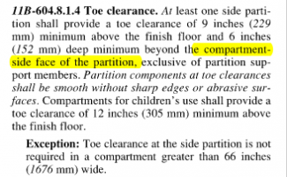

I'm wondering if it is impossible for full-height (floor-to-ceiling) walls comply with 604.8.1.4, which says toe clearance must extend 6" min BEYOND the compartment side face of the partition.
So even if my 2x4 stud walls had 66" clear instead of 60", 604.8.1.4 wants toe clearance to add up to 72".
If my walls are 100" apart, 604.8.1.4 wants toe clearance to be 106", etc.
In other words it would be impossible for the side walls to touch the floor and still comply with 604.8.1.4.

Mark, thanks. In a single-accommodation toilet room (one toilet, one lavatory), there is no "partitioned space that is located in a toilet room".
Therefore this room is not a "compartment", and therefore the extra 6" does not apply. Depending on layout, a single-accommodation toilet room can be as narrow as 60" wide.
Is that correct?
Is that correct?
IMPO, Yes. That is correct.
