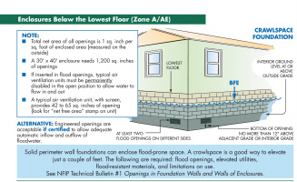

Homes over basements that are below BFE are built on a daily basis and compliant with all FEMA and NFIP requirements, hence the wet-floodproofing requirements. Some municipalities & states have stricter requirements than FEMA, especially those participating in the CRS. Any new construction built below BFE can only be used for parking, access to the property, and storage. These areas need flood vents and other wet-floodproofing designs incorporated into the construction.
On a personal note, I think people are idiots for building anything below BFE. It is, however, allowed.

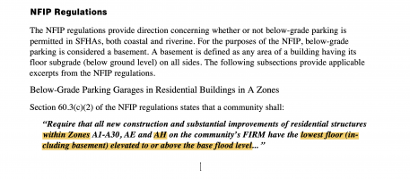

"Below-grade areas, including areas used for parking, are not permitted under residential buildings in SFHAs identified as Zone A."
See NFIP Tech Bulletin 6 January 2021 page 1.

From the ASCE-24
2.7.3 Installation of Openings Installation of openings shall meet the following criteria:
1. Each enclosed area shall have a minimum of two openings,
2. Openings shall be in at least two walls of each enclosed area,
3. The bottom of each opening shall be no more than 1 ft above the higher of the final interior grade or floor and the finished exterior grade immediately under each opening, and
4. Openings meeting requirements of Section 2.7.2.1 or Section 2.7.2.2 that are installed in doors and windows are permitted.
I've worked directly with FEMA and have seen this done legally in two different states. What you and I like and agree with and what is allowed are two different things.
The ASCE section you cite is not applicable to a basement (ASCE's definition of a basement). The area below the first habitable floor is not necessarily a basement. This is a common misunderstanding.
But ASCE 24 is explicit (page 61): "The standard permits basements in nonresidential structures but prohibits basements in residential structures."
I am using FEMA's definition of a basement (sub-grade on all 4 sides). There is no way for water to flow out of a basement. But even worse, there is no way for water to freely flow in to a basement. Result? Exterior hydrostatic pressure builds up, and the basement walls collapse.

The section I posted is reference to from coastal A and VE zones further along. Enclosed areas below DFE are allowed in the high hazard area for coastal construction found in chapter 4. Again, you can't read one thing and apply it across the board, especially when it is referenced.
