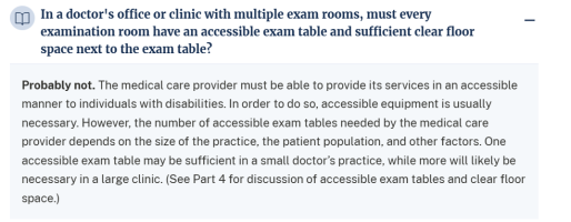

By the above requirement it seams that every exam room needs to be accessible. However is that really the intent of the code, if they are all providing the same service?
The U.S. Access Board technical guide for new construction indicates that every exam room needs to be accessible, here’s an image from Page 3 of the PDF:
Here’s a link to that technical guide: https://www.access-board.gov/ada/guides/chapter-2-new-construction/
I would argue that they don't all need to be accessible; just like every toilet fixture, counter, kitchenette, parking space doesn't need to be accessible.
I had a similar thought, how not every toilet stall has to be accessible. But providing accessible access into a room is different than making every element in the restroom accessible, Sifu’s #4 post provides commentary supporting why not every element needs to be accessible, and the image above notes that elements used only by employees do not need to be accessible.
my final conclusion is that not every single room within the whole space that provides the same dental service needs to be accessible as long as a reasonable amount of those spaces are accessible, e.g. I out of 4 exam room, 1 out of 2 imaging rooms.
