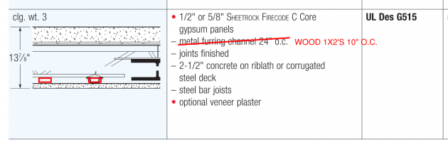

I have an existing floor that is very similar to a 2hr UL G515 floor assembly. The only difference is instead of metal furring, there is Wood 1x2's - 10" o.c.
How do a determine the hourly rating of this floor? I know about chapter 721 and 722, but what I can gather there's no area that talks about wood furring.
Are you sure that it was rated? What was the original construction type too?
From what I can gather, the original construction was probably a 2A.
It's a 3 story building with exterior brick, and steel beams and steel joists--most of which are encased in plaster w/ metal lath.
Unfortunately the Resource A Guidelines on Fire Ratings of Archaic Materials and Assemblies doesn't seem to address it either.
II-A with wood furring strips?
I'm sorry, but if it were my rodeo, there is no way I would accept the continued use of this as a rated assembly if it has wood furring in a non-combustible construction type building. The wood furring should never have been permitted (IBC Section 603), so trying to justify its continued use for fire rated construction is a reach in my book.
I would need something from the legacy code under which the building was built that justified the use of wood furring for me to change that opinion. And I just don't believe that you will find that. I have a feeling that you are looking at a non-conformity that was missed at original construction.

From the 2018.... I don't see how it would meet either of the (3) options. Does not appear to be filled, and fire blocking every 8-ft in each direction seems unlikely.

Nope. You can't add insulation to a horizontal UL assembly unless it is listed in the assy. Also, what he is showing is not an interior finish, it is part of a fire rated assembly.
I think your best bet is an engineering judgement. It might be hard to find a fire engineer who will write the judgement you want. The owner may have to pay to replace the gyp membrane with steel furring.

I would agree with the EJ if you can't find a proper listing...
my humble opinion is that you rip out the existing drywall and the wood furring strips and redo the ceiling so that it complies with G515. Without knowing the details of your project, i'm assuming that you need a 2 hr floor rating? I'm also assuming that your dealing with a plain drywall ceiling and that it's not ornamental and needs to be preserved? if it's just a plain drywall ceiling, rip it down, rebuild it so that it complies with an approved system and move on.
you may be able to add metal furring and another layer of drywall so that your system becomes a hybrid of G515 & L505 and you'd have to sell it to the AHJ but i still think the best bet is to rip it down and do it right. heaven forbid that there ever be a fire but if there is and you find yourself in the witness seat, it's better to say that you followed a tested and approved system than saying that you left a deficiency in place and put a bandaid on a turd and hoped for the best. it's one thing if the floor/ ceiling was compliant at the time it was built, but from the other comments it sounds like it was never compliant and should never have been built that way.
