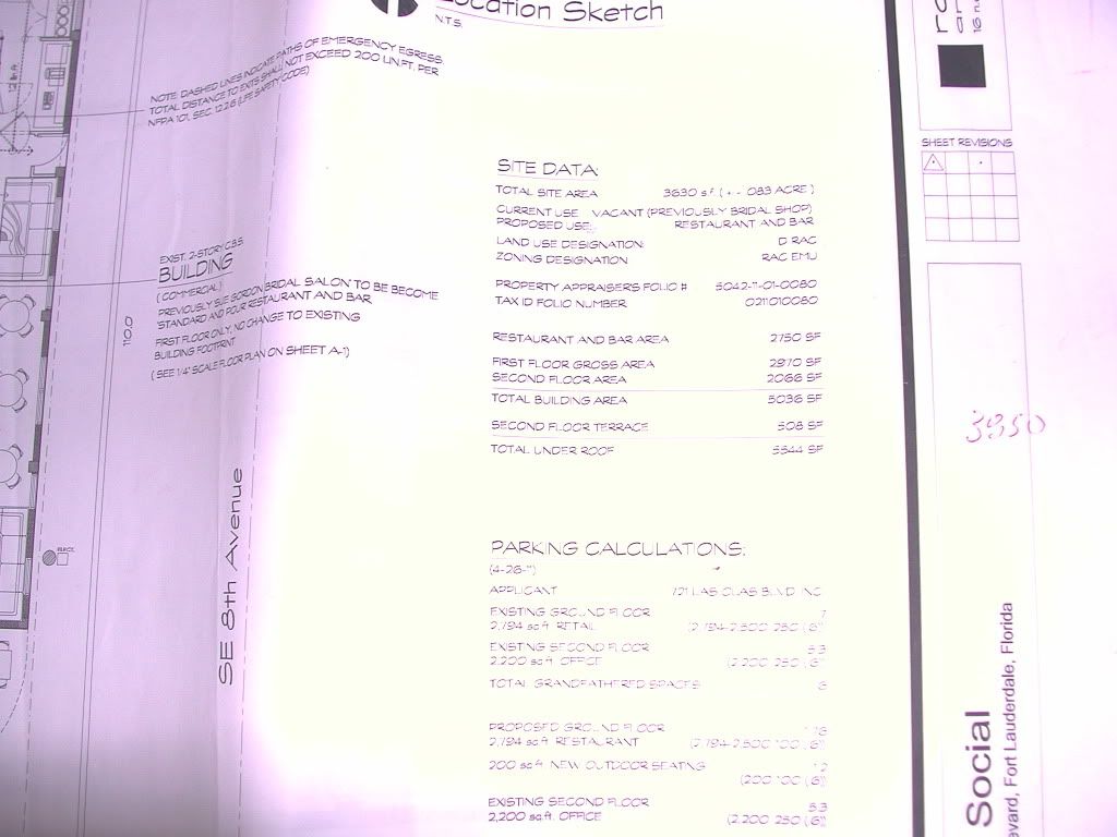

Can anyone tell my why the second floor square footage is added to the first floor here? Second floor is a completely separate lease space, separately metered, no access from 1st floor tenant space. I'm trying to VE out a very pricey automatic shut-off lighting control system.
Thanks.
Dennis said:
The total sq. ft of the building is pretty standard info on plans I see.

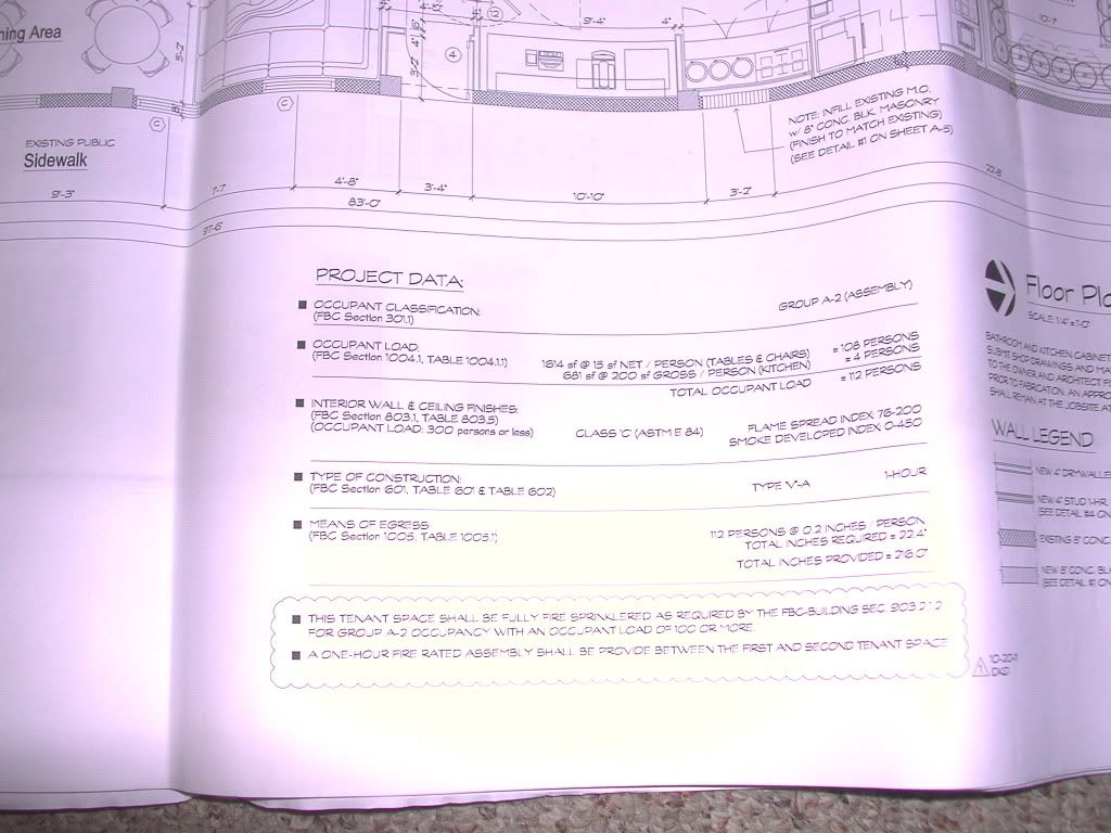

Of coarse, BUT, IMO the architect made a mistake. As stated the 1st and 2nd floors are completely separate lease spaces. so I want to use this;
FBC 13-202 BUILDING. Any structure that includes provision for any of
the following or any combination of the following: a space
heating system, a space cooling system, or a service water heating
system. For each purpose of this code each portion of a
building separated from other portions by a rated fire wall shall
be considered as a separate building. The term “building” shall
be construed as if followed by the words “or part thereof.”
To defeat this;
FBC 13-415.ABC.1 Controls.13-415.ABC.1.1 Automatic lighting controls. Interior
lighting in buildings larger than 5,000 square feet (465
m2) shall be controlled with an automatic control device
to shut off building lighting in all spaces.
FBC 13-202 may clear you based on the language on the bottom of project data in the clouded area. That may be what you want to hear, however..........
The reality is that it is NOT a fire wall as per the definition of firewall. I don't think you can separate these areas as separate buildings horizontally. Look up the definition of "Fire Wall" or "Firewall" and you will see what I mean.
FIRE WALL. Fire-resistant wall, having protective openings,which restricts the spread of fire and extends continuously
from the foundation to or through the roof, with sufficient
structural stability under fire conditions to allow collapse of
construction on either side without collapse of the wall.
Crap.:oops Thanks Jeff.
