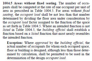

Hi all,
I have a client that is converting a warehouse space into a gym. Think cross between cross-fit and traditional gym. So lots of equipment and open spaces for flipping large tires, etc. Some of the equipment is rather large. Some of these more cross fit areas take up a lot of space. When running occupant load with 50 gross for exercise it comes to a really high amount, approx. 450. He's been operating over a year, and has never had over 100 occupants. He only has parking for 100 vehicles. The high occupant load will trigger him needing to upgrade the building from a category risk II to III and we'd like to avoid that.
I've reached out to the fire marshal asking for recommendations on how to determine occupant load that is more reflective/realistic for how they use the space, and was unfortunately told they would only consider the 50 gross for exercise.
Does anyone have any suggestions? Have you been able to use other means of measuring spaces that don't exactly fit the load factors. LIke counting equipment/stations?
Where did you come up with an occupant load factor of 50 gross? "Gymnasium" is not one of the occupancy types listed in IBC Table 1004.5.
I remember that many years ago (more than 20), our State Building Inspector's office said to use a net square footage for gymnasia, deducting the floor space occupied by equipment such as treadmills, universal gyms, etc. Unfortunately, I don't recall what the square footage factor was that they said to apply to the net remaining floor area. If the equipment is large, try using 50 but base it on the new rather than the gross and see how that works.
And, of course, you can always ask the Building Official to approve a non-standard occupant load. If the owner can provide verifiable occupancy numbers over the course of a year, that plus the lack of parking for anywhere near 450 people might be persuasive.
So he's converting a warehouse to a gym but has been operating for over a year? If this is the case then the project is already one the AHJ isn't likely going to be flexible with because the space is already out of compliance and in operation.
I have had the same experience as a BO; specifically an S-1/S-2 change of occupancy to an A-3. They were attempting to open a crossfit like business in a 3,000 sq ft warehouse space and this brought with it many issues because they only wanted to use a portion, and just leave the rest open. They also claimed they would only ever have 25 people at a time in an attempt to get out of added plumbing facilities, means of egress issues, increased risk category, etc - and they wanted to use the exception to Section 1004.5 to do it, which I declined, and they found place in another jurisdiction.
I'm a private code consultant now but when I was a BO, I never authorized the actual occ load for buildings when people were the hazard, only when commodities were the hazard. The IBC commentary explains the reasoning for this exception and to use it "sparingly".
The occupant load factor for "exercise rooms" uses gross sq ft for determination so deducting area for the equipment isn't possible but you could ask to use the more restrictive 15 net factor for Assembly function of space, which will allow deductions for equipment, even though the required area per person will be much smaller. Maybe calculate this and see what you come up with. It might provide you with the numbers you're looking for and in a way the code would allow (in my opinion).
The only other possible solution I can see to use is to Chapter 13 of the IEBC but it will be expensive and multiple elements need to be looked at so it might not work anyway. I have done one of these in my career and it was a lot of work for the architect as well as the jurisdiction but it is a possibility, when all other options are gone.

Propose a tabular occupant load for egress and design occupant load for everything else? Otherwise you're stuck with +400 and deal with what else comes
